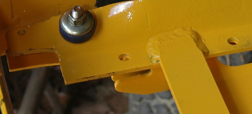

Right or wrong, here is a pic. This one is not runnin', yet.

Cad did you use the cup washers on the bottom side as well? Just got my blue Moog 5342 kits in the mail yesterday and will be setting the motor this week.
Old 04-28-2013, 01:52 PM
Been a while, I believe I did use them under also.
The back bolts gotta point "down" or the bolt will hit the engine!!
My "thing" that I did was to make sure everything is square and level using an extra oil pan.
(I guess you could pull the one you got off your engine)
I mostly wanted a level "spot" for the engine to sit. I could not think of another way to get those 4 bolts installed correctly.
