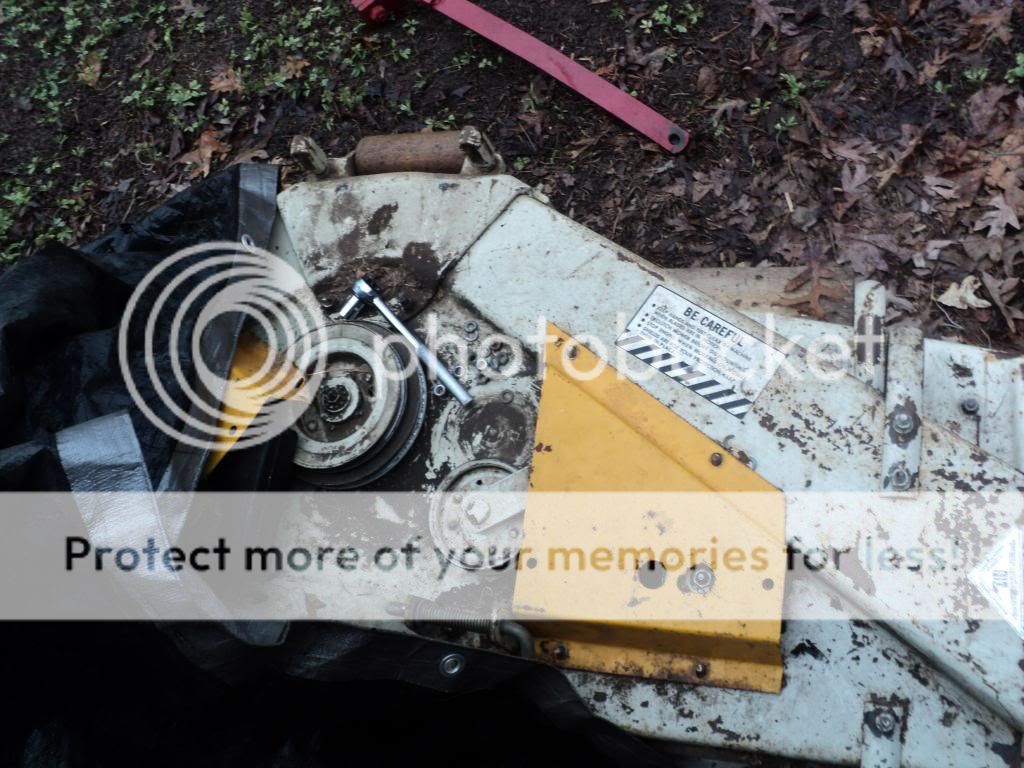

ToddW's Avatar
ToddW ToddW is offline
Posts: 149
I measured it this am before my workday-will have to uncover it again from outside storage pile of stuff tonight and post pics.

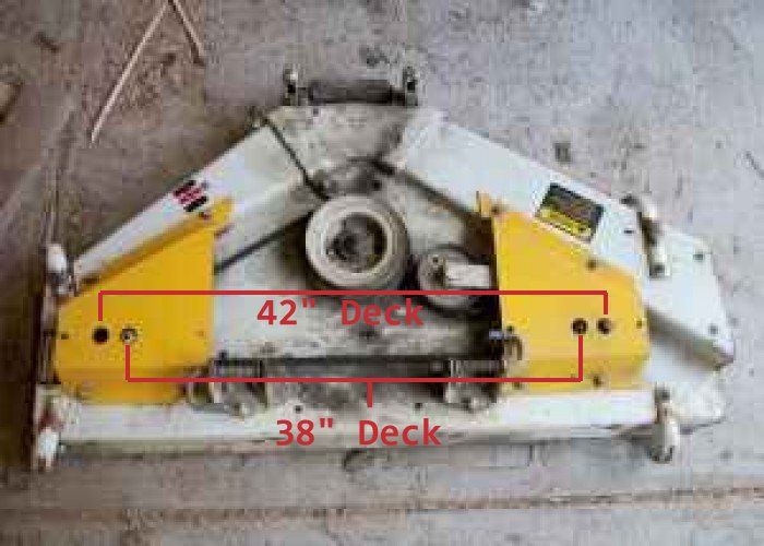

Old 05-02-2013, 03:42 PM
If it is a centered pulley set up, then it is either a 38", 42". The 48" would measure way over 50" if measuring just the housing. If there are belt guards over the outer pulleys, then look to see if the pulley grease zerk is centered in the inner access hole on top of the guard or the outer. If it is the inner, the deck is a 38", if the outer, the deck is a 42".
Old 05-03-2013, 11:00 AM
ToddW's Avatar
Posts: 149
Looks like Mine is a 42 based on what your pics shows of grease hole aligment
that means the belt I ordered should work
