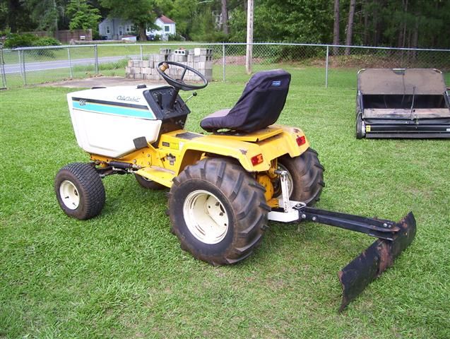

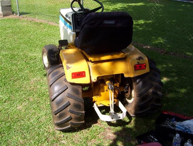

Welcome to OCC! Here's what you'll need to attach the cultivator to your 782. Sounds like you just need the Brinly adaptor. The cultivator will hook up like the rear blade does in the second pic. Hope this helps.
Old 07-12-2013, 11:25 AM
YES! That's a great pic! That should help him! Thanks Allen!

That's exactly what I need. The pic is perfect. What I'm missing is everything in white along with the "rod" that goes into the top, rotating part of the hitch. I thought I'd be able to get all that from Xtreme but apparently not. I'm home later tonight and I'll post a picture of what's on the tractor now.
