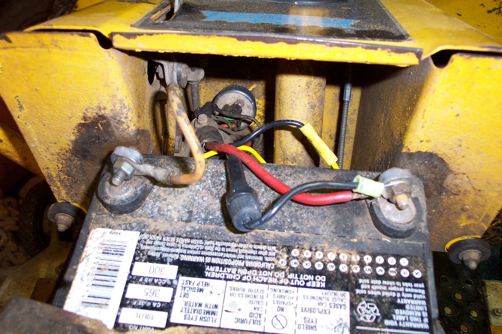

I finally decide to fix the gas tank. I rinsed it THOROUGHLY with water. I found 2 pinholes that were leaking. One was near the seam, and the other was near the filter. I fluxed and soldered both areas, then just for fun I had some grey paint left over from another project. I put some electrical tape between the tank and its mount...couldn't hurt.

I had a 1966 model 122 and the battery was installed different from yours.
Plus you should get the correct style hold down to reduce the chance of an electrical fire/mishap.
