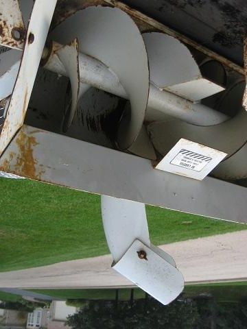

Can anyone provide me w/the measurments of this shield that is missing here on my BB36? All I had was the piece the bolts go through. A PO had cut off the rest either that or it broke off.

Parts book shows it is just a flat piece, bent at the end and bolted. Since no one has answered, I'd just make one that is about 6-8" long, if it's too long cut it down. Start with 8" and make it shorter from there.

Which part# in the diagram are you looking at?
Old 10-07-2013, 06:40 PM
#32..... Sorry, forgot to reference it.
I believe that is the part he was referring to.......
Old 10-07-2013, 06:51 PM
Thanks Jonathan! I thought that was the one but wanted to make sure.
I will have to look at mine and measure it.

Is this it?

Oops photobucket flipped it

That's it guys and thanks
Another fellow came up w/the measurements for me
4 x 6 plus the bend
I'm gomma make itbup outta S/S and polish it!!
