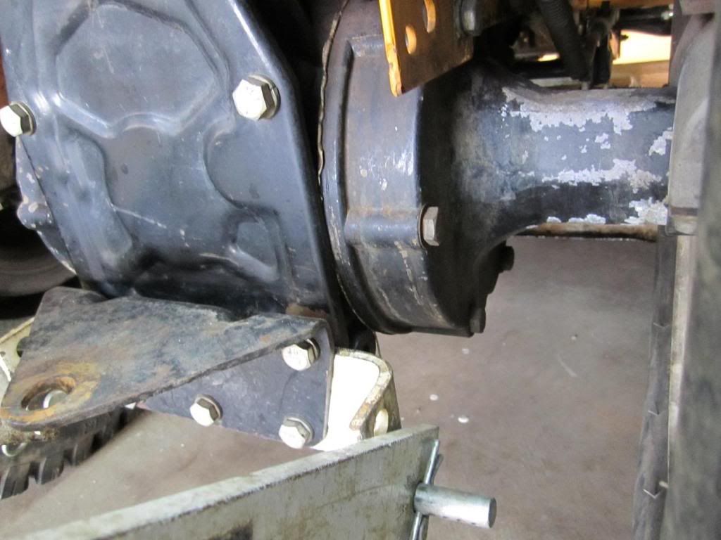

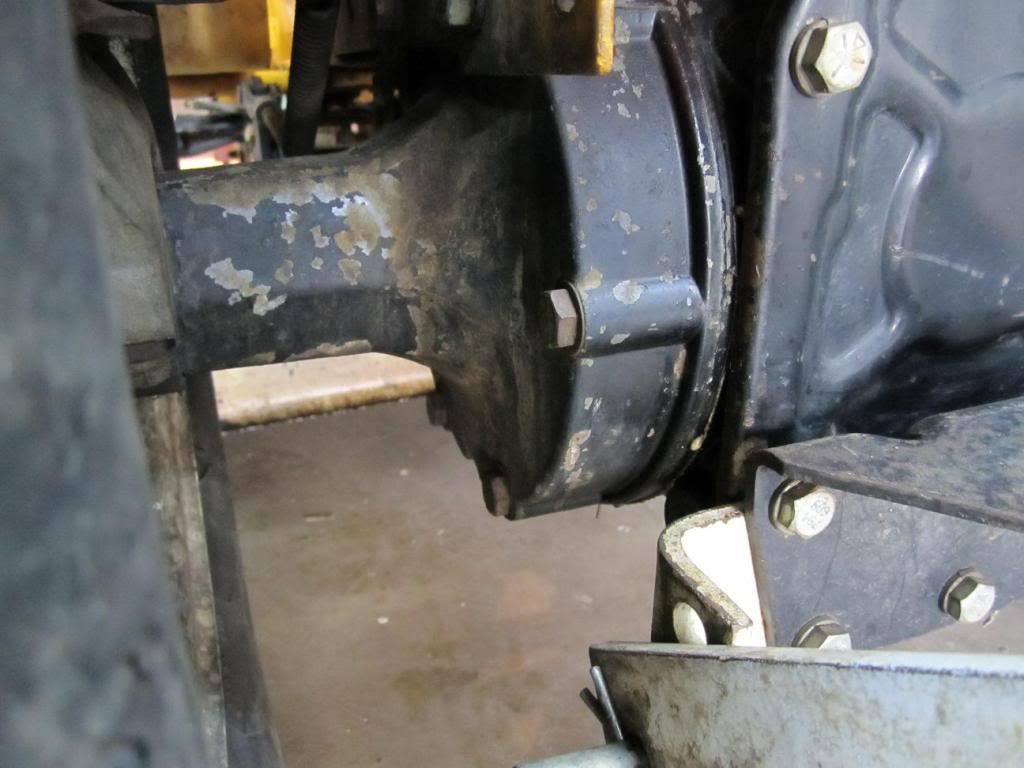

I didn't notice the problem with your hitch until Adrian pointed it out. You basically have three options. Buy a aftermarket Cat 0 3pt, buy a new lower bracket that has "ears" that get bolted to the axle tubes, or I know a guy who make a really nice setup that bolts to the rear of the frame. The first 2 options you can get at http://www.xtrememotorworks.com/. The last option, I would have to track down his e-mail for you. Last I knew, he was charging $150 for a setup.
If you really want to get out and plow, you really need some wheel weights and ag tires, or at least chains on your turfs.
Now for your tiller. If you go the Cat 0 route, then the self powered tiller is going to be your only option. If you stick with the sleeve hitch option that you aleady have, you can use just about any tiller with some modification. mainly you have to change the pulley on the gearbox that bolts to the rear end. It would need a 5/8" pulley.

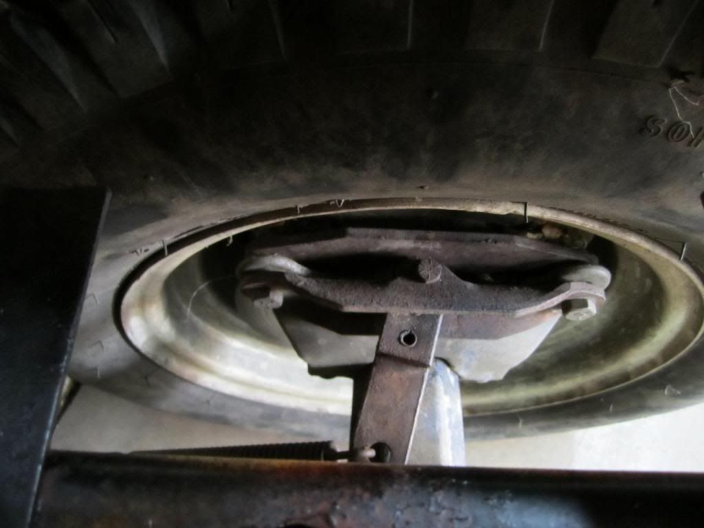

So I decided to take a few pics of the tractor but more on the component side and innards.

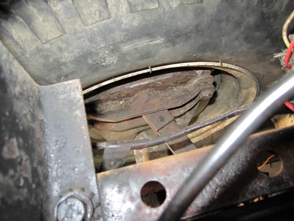

The brakes don't actually function as they should as in stopping the wheels. The pedal does take the hydro back to neutral though. Not sure it's worth fixing those at the present since I don't have any slopes on my property.
More pics of the rear end and current hitch.

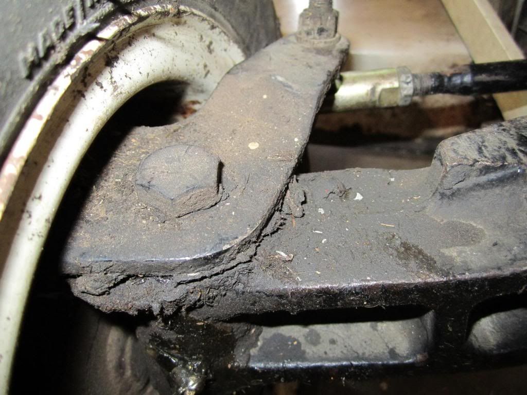

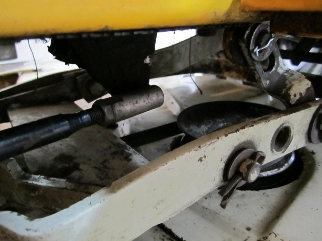

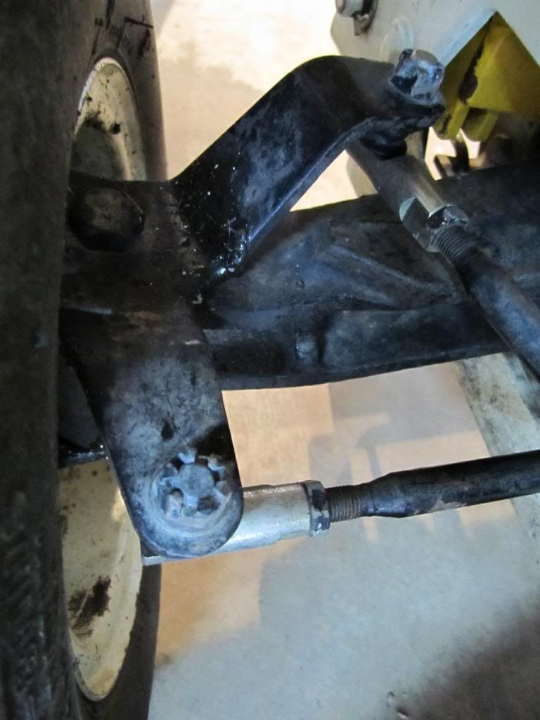

Steering at the wheels.

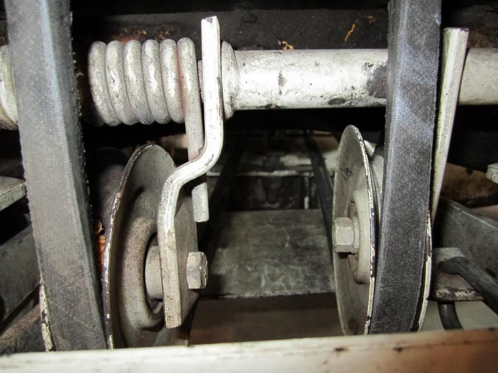

Mule drive I believe it's called.

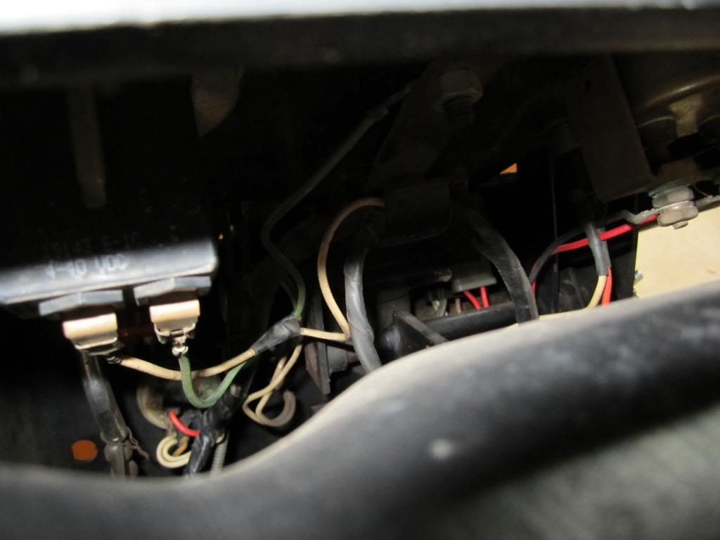

Wiring behind dash. Kind of dark unfortunately.

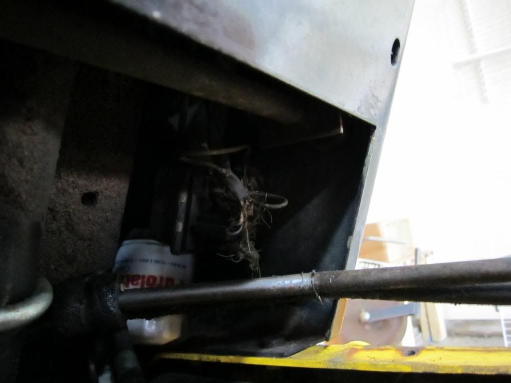

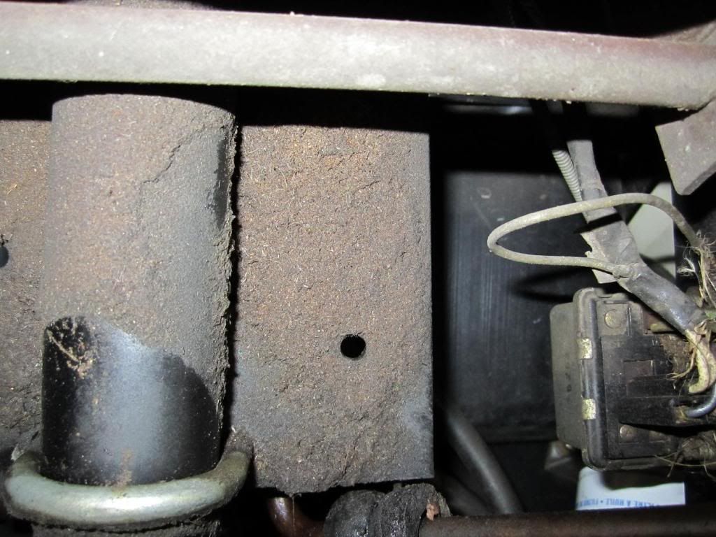

Now we get to a couple areas I'm sure you guys will see and will throw up red flags. I didn't see a couple of these while taking the pics, but now that I look at the pics I'm a tad concerned.

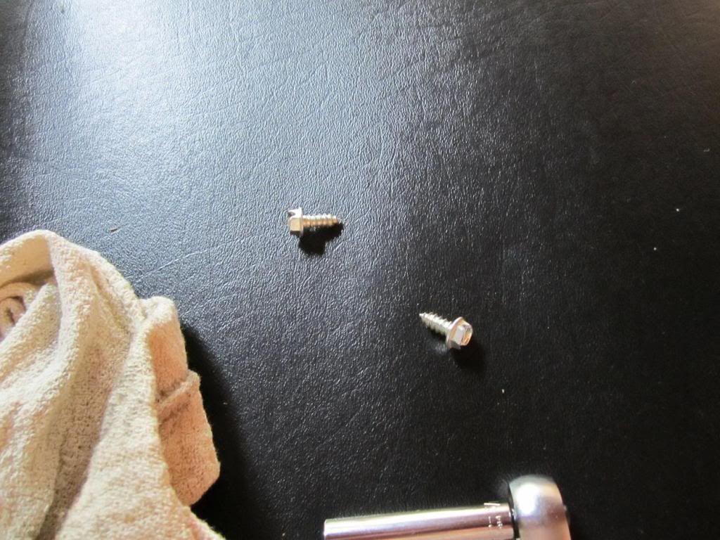

These are what was holding on the center cover plate.

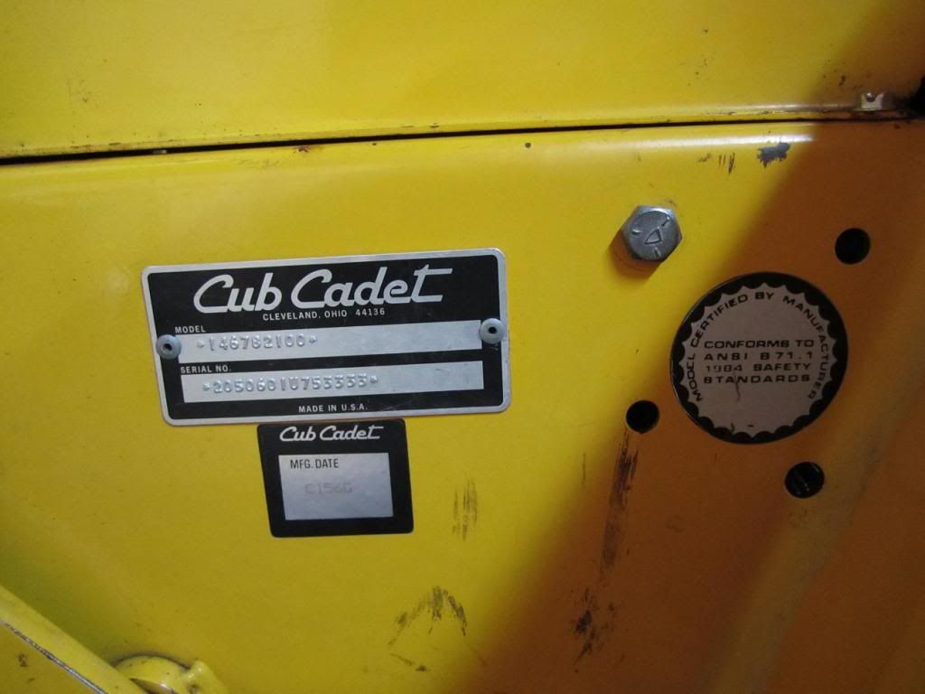

And in case anyone feels up for translating this.

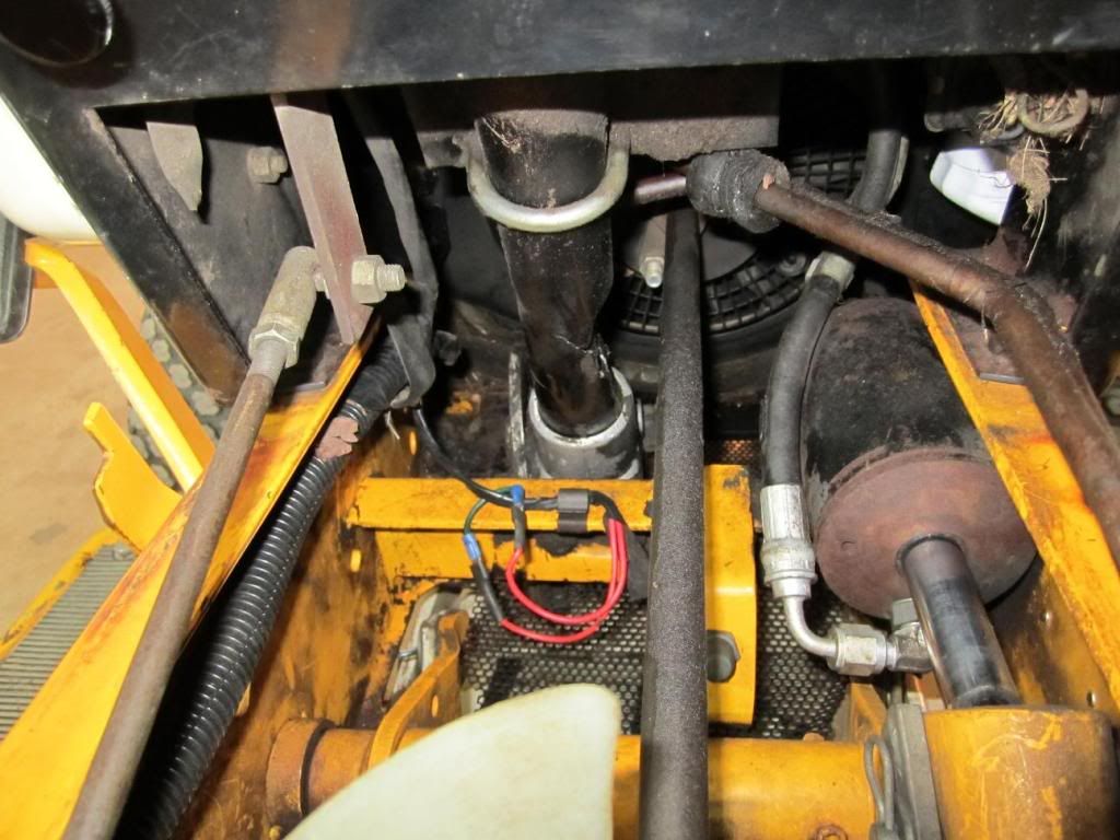

Great pics Shawn.
Looks like the steering column got whacked by the drive shaft at some point in its life....do you notice any issues with the steering?

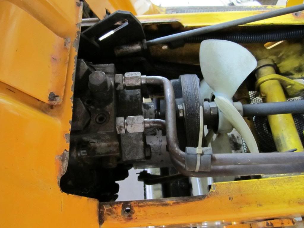

The rest of it looks pretty typical for a mid 80's CCC. Keep an eye out for leaks around the hydro pump and tranny, nothing to really worry about, but it can get frustrating searching for seepage...ask me how I know...I just replaced all the seals on my 1211's hydro pump and transmission.

It doesn't turn hard or anything, but it doesn't seem like it has the turning radius I'd think it should. Could just be the way the drive though.
The joys of jumping into the deep end with lead shoes on!
