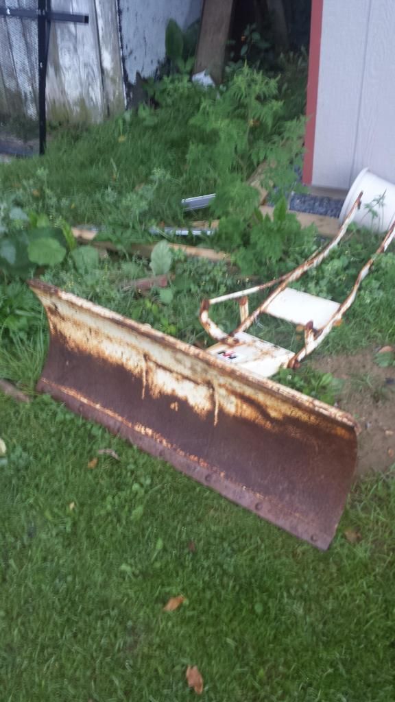

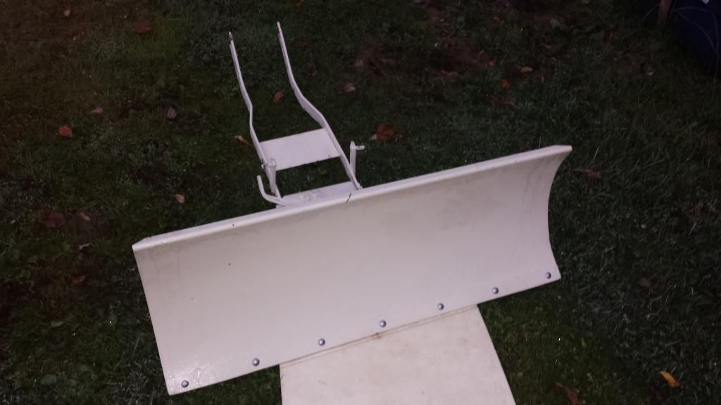

Well as promised I would put up some Pictures of my blade...the 1st two are what I started out with:
I was going to have the whole deal sandblasted, but the guy wanted more than what I payed for the thing to do it so I opted for using electrolosys and I was very pleased with the results.

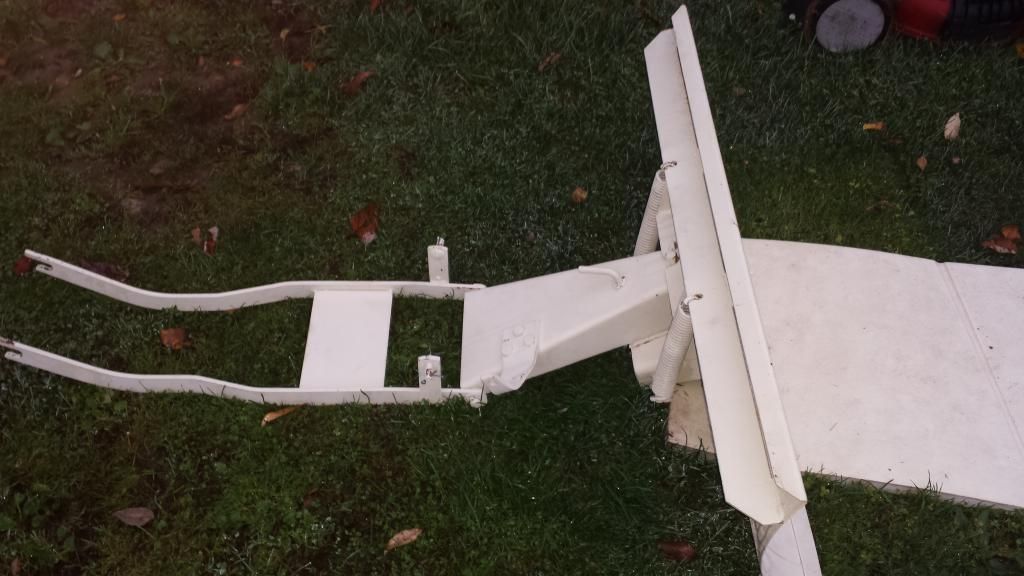

The only thing that is missing is the IH decal but that won't affect its ability to plow snow....

steve looks great ive gotta do mine for my 70 its almost that time of year , think the electrolysis would destroy tire chains that are rusty ?

I don't think so this was pretty rusty in spots and it took care of it...sandblasting would have been quicker, but there are limited folks in the valley where I am at that do it and the ones that do are out thru the roof expensive! I had good luck with using that process thus far! I will add that once you take the part out of the solution you need to dry it off and prime it or oil it cause it will flash rust quickly!
