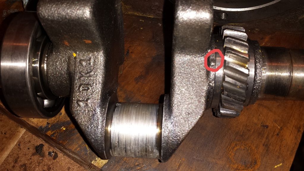

Still can't figure out the timing marks on the crankshaft. I don't see the dashes as shown on page 6 of this thread:
http://www.onlycubcadets.net/forum/s...ng+mark&page=6
- Tim
  #26
Old 06-06-2015, 12:47 PM
dvogtvpe's Avatar
dvogtvpe dvogtvpe is offline
Posts: 1,585

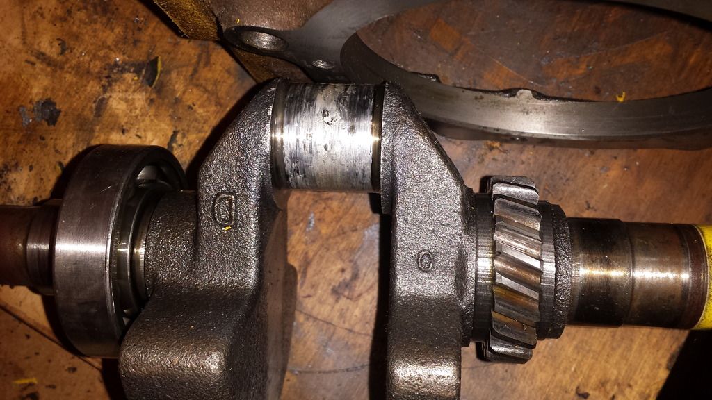

you won't have a nice mark like the other crank you linked to because that's a 14 crank. you may have dot. I can make something out in the lower pic that looks like a dot. or shrapnel damage. don't fear. if you put the cam so the valves are at split overlap and install the crank at the TDC position who needs timing marks.
Is this what you noticed?
Thanks-
- Tim
  #29
Old 06-12-2015, 10:05 PM
northernredneck's Avatar
northernredneck northernredneck is offline
Join Date: Feb 2015
Posts: 40
Holy grenade! You were right that rod is cashed. As for timing marks my k241 has a dot on the cam and a dash on the crank. Best of luck to you.
