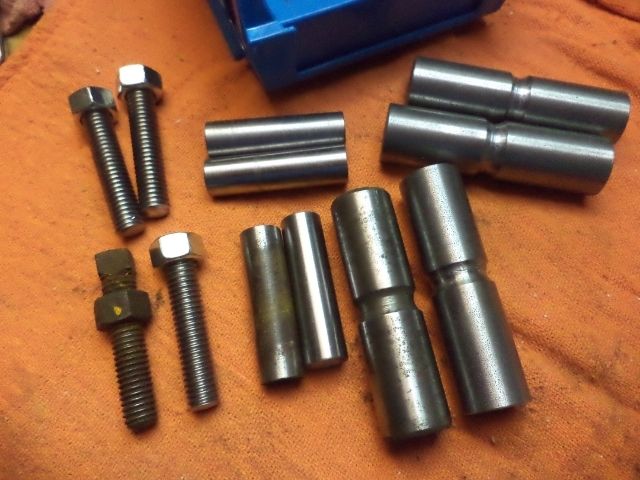

Look what I just finished
Original parts on the left. To keep costs down, the adjustment screw is all thread with a welded nut. $30 plus shipping for the three parts.

They look amazing! Now everyone from the rusty Midwest has a place to get these not available parts for their gear drive brake rebuild.
Thanks Jeff and Lew!!!
