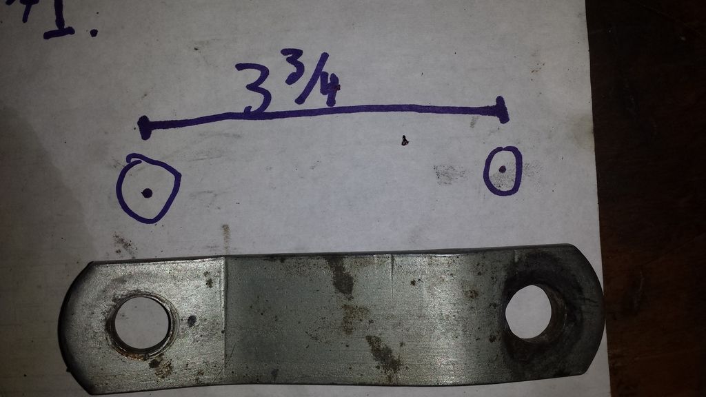

Yes it should! Hopefully! I just need that Cross Shaft Support Strap. Can anyone help?

No reason you can't make one of your own, it's just a piece of flat bar with 2 bends and 2 holes in it.
Unfortunately, I don't have the tools to make it otherwise I would. I am looking for a minimum of the dimensions of the piece I would need to make, but am hopeful someone has an extra one laying around or could make me one.

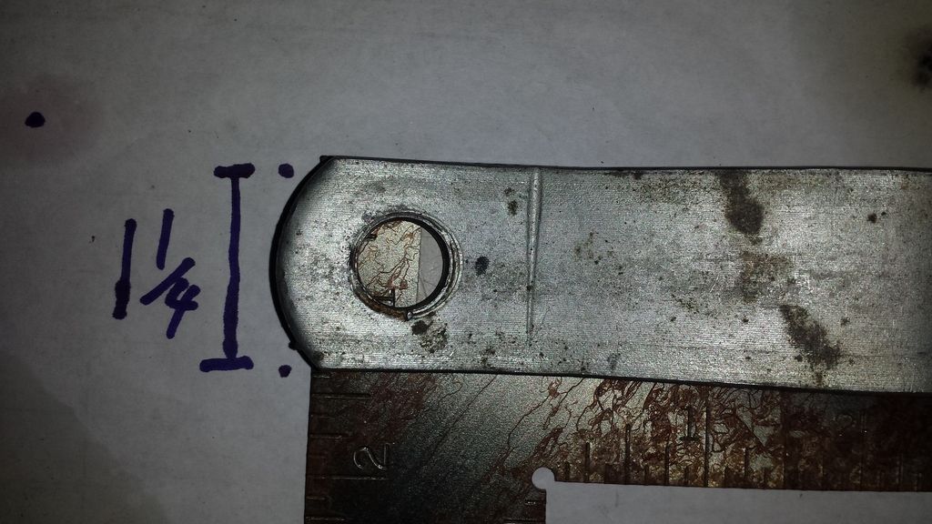

Posts: 393
Here check these out.
.25 inch steel.
Holes are half inch and measured center to center.
- Tim
.25 inch steel.
Wow, awesome! Thanks bud!

Whats the diameter of the holes?
