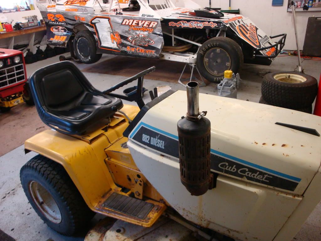

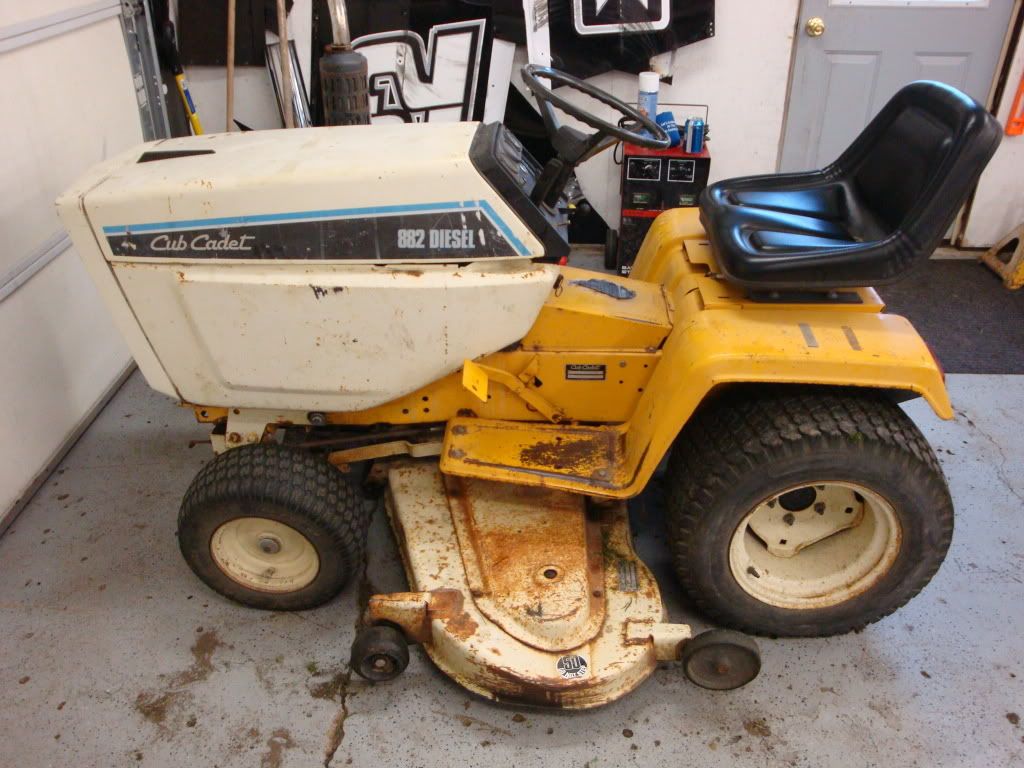

Ummmm.... WHERE ARE THE PICTURES OF THIS LITTLE GEM???

Nice 882, you got there.

Nice!
Love the 882s, and I wish I could find an OEM muffler like that.
I did the math to get one from the Cub parts dealers and it was approaching $600.
