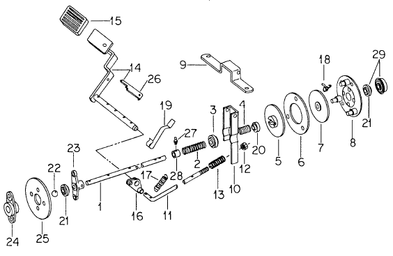

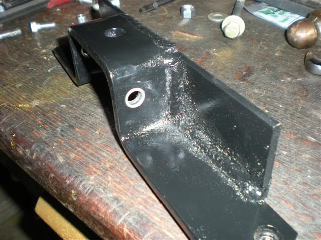

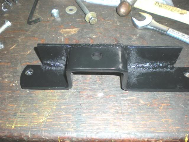

Part number 9 (clutch lever hanger assembly) on this page will flex some when using a heavier spring.
Mod done to clutch lever hanger assembly:

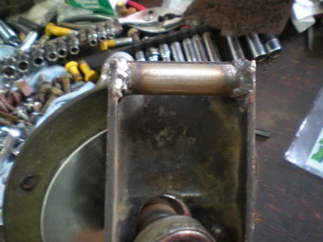

I also like to add a bushing to the clutch lever ( part number 10 ).
