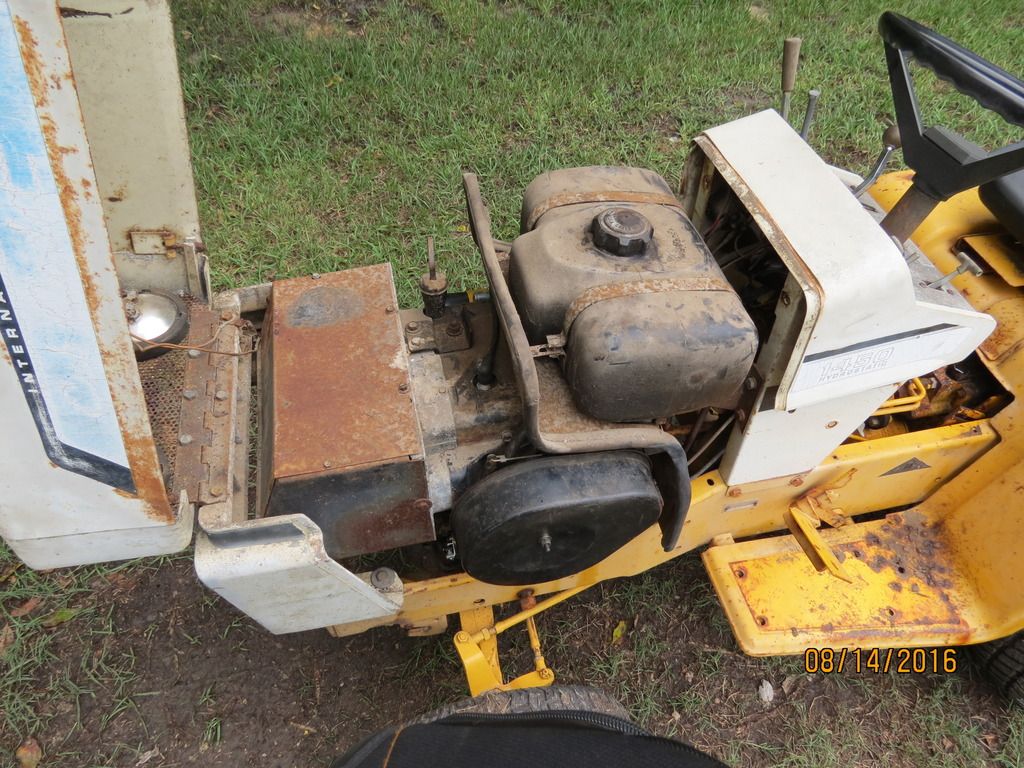

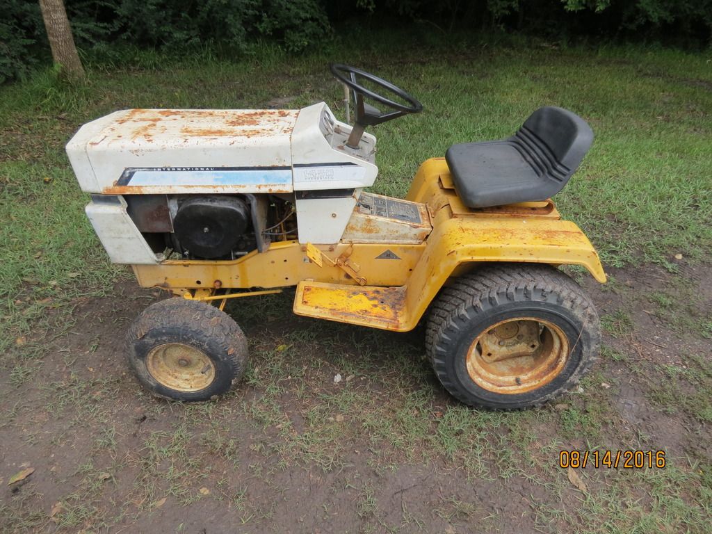

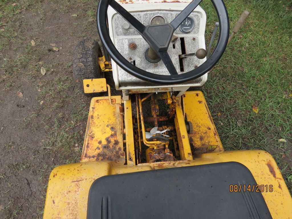

Now back to this 1450. It is rough. I eventually got it started with the help of a rebuilt carb, new points, new condenser and like new coil. All of these parts were off of a 16hp Kohler I had bought a couple of weeks ago, (jmech was gracious enough to tell me what would and would not be swappable with my 12 hp in the 1200). As it turns out, the 14hp and the 16hp take some of the same parts, so the 16hp kohler purchase has paid off already! Now that it runs, I have found out more about what it needs. First off the motor smokes. Second, the hydraulic control valve for the deck and rear lift is seized. Both valves are stuck down. I squirted them down with pb blaster in hopes that they will free on their own. And lastly the forward and reverse alignment is way off. The neutral position with the dash control arm still caused forward movement. I will eventually have to work through these issues.
Any advice on the seized hydraulic valves?
Once I get the fender pan off I can take a closer look at the shift linkage and look for wear. It is WAY off somewhere.
Along with the 1450, I bought a very good condition fender pan, a nice pair of side panels from a 782 that will fit my 1811. A spare hood for the 1450, front top and bottom tins for a K17/18 for my 1811, an extra upper nose piece for the 1450 or 1200, and a deck lift assembly (that may or may not have come from the 1450). All this and delivery for 350.00, I of course, did not complain. Here are some pick of the 1450. Thanks, TB

Thanks twoton. Is the secondary stick for the front hydraulics? TB
