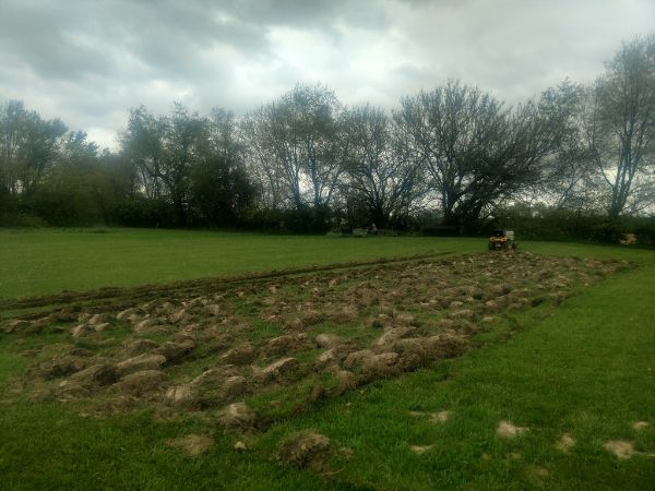

Even with correct initial setup, I had a terrible time getting the plow dialed in. I would run a 60' row, adjust, repeat over and over till I got frustrated and gave up. I know the subtle plow is not meant to turn virgin sod, but I also know it can do much better than what I was getting out of it. I had no traction in the front end, the tires kept sliding way right and over the previous furrows, and very little sod actually turned over.
Pic from today, but shows how bad yesterdays plow work was. It will still be tillable but it's not going to be fun...
