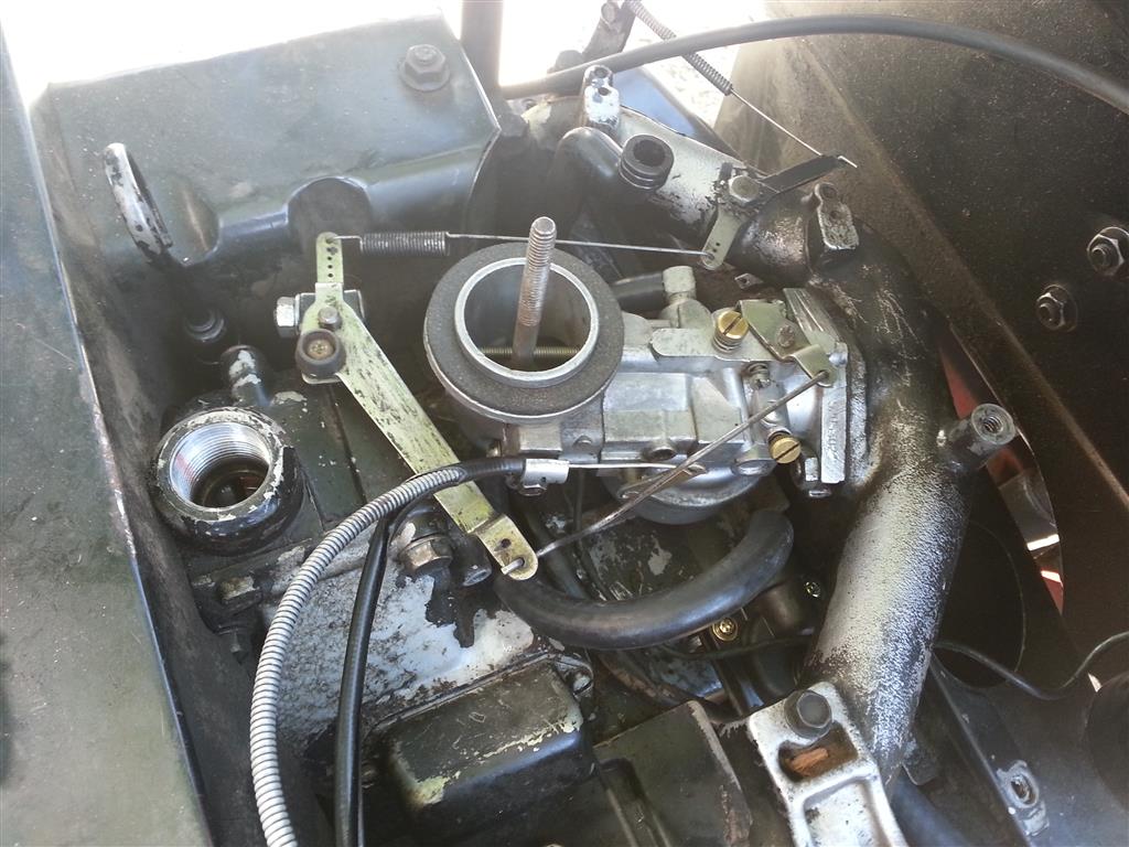

That looks to be the good adjustable carb.
Hopefully the carb is in good shape.
Is this a Walbro? It appears to be original. Honestly, the tractor sat for 15+ years, I added fuel, got it to flow past the inline filter and it literally fired right up!

The Walbro is the junky one. That would be a Carter #26.

Thank you! Never knew, Is the Carter Carburator marked in a way? I have just purchased a second carb that I am thinking of rebuilding.
Here is what I noticed.. I replaced the Governor spring. All is well, but before, and after the spring replacement, I feet that the the throttle control goes from zero to hero in the first 1" of travel. Meaning, from about 1" and UP, there is zero change in engine speed the higher you lift the throttle.
Does that make sense?

The Walbro is clearly marked, and only has adjustment for idle. They are a fixed main jet. The Carter and clones have idle mixture and high speed mixture adjustments such as this one.
