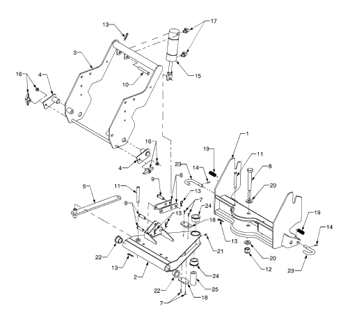

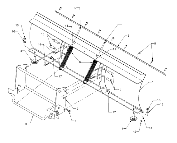

Seeing how it is attached now, I can defently tell it aint the plow setup made for your tractor.
Heres what the book shows for a 3235
A bit more complicated and not so easy to take off in the spring and put back on in the fall.
