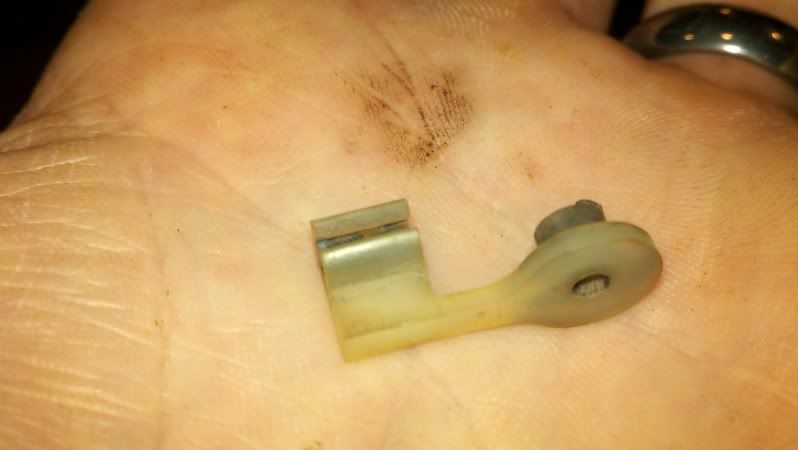

I have a 1450 I'm putting back together and noticed the piece in the pic is damaged. It is a small plastic clip that attached carburetor linkage. I tried using the parts lookup - but in the drawing it is not clear if this is the part or not.

Its the 6th item down here http://ihccw.com/carb.html
KOHLER CARBURETOR LINKAGE RETAINING BUSHING
