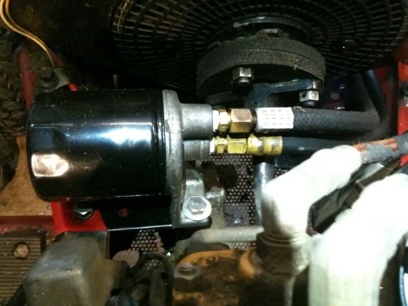

A little progress tonight, getting closer. Here's the plate where the remote filter head mounts;
Filter in place;

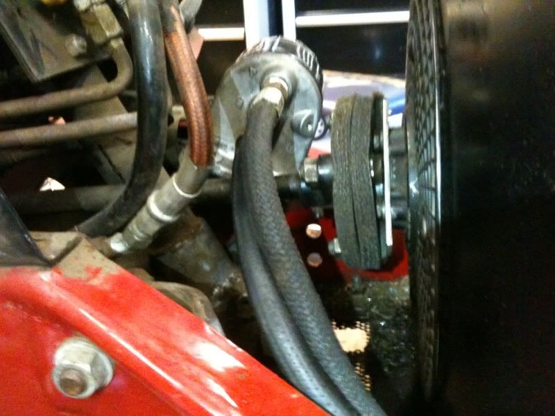

I know the lines are going over the drive shaft, but I think it will work.

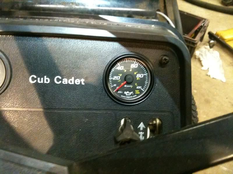

Next I took Matt's advise and relocated the hour meter under the hood. Then put the oil pressure gauge in it's old position. Thanks Matt.

Looking good...If I were you'd I'd put a few washers between the bracket and the oil filter mount to get the lines a little further away from the driveshaft.
The pictures are deceiving, there's a good 1.5" between that lower line and the drive shaft. My rag joint was shot when I pulled the engine, it was basically spinning on (1) of the (2) bolts.
Even as bad as that was it would not have swung far enough to hit the lines where they are at now. If you look at where the bracket attaches to the frame rail, I have it under the rail, I could move it the top, but really feel there is no need.
  #38
Old 04-21-2012, 10:27 PM
Ok, that's not bad...in the picture, it looked like there was about 1/4" of clearance with the bottom line.

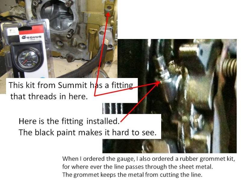

I would like to put a oil presser gage on my 1812. How did you pulm the lines? could you get a pic?
http://www.summitracing.com/parts/EQU-6244
http://www.summitracing.com/parts/SUM-890091
I'll get more pictures tomorrow.
