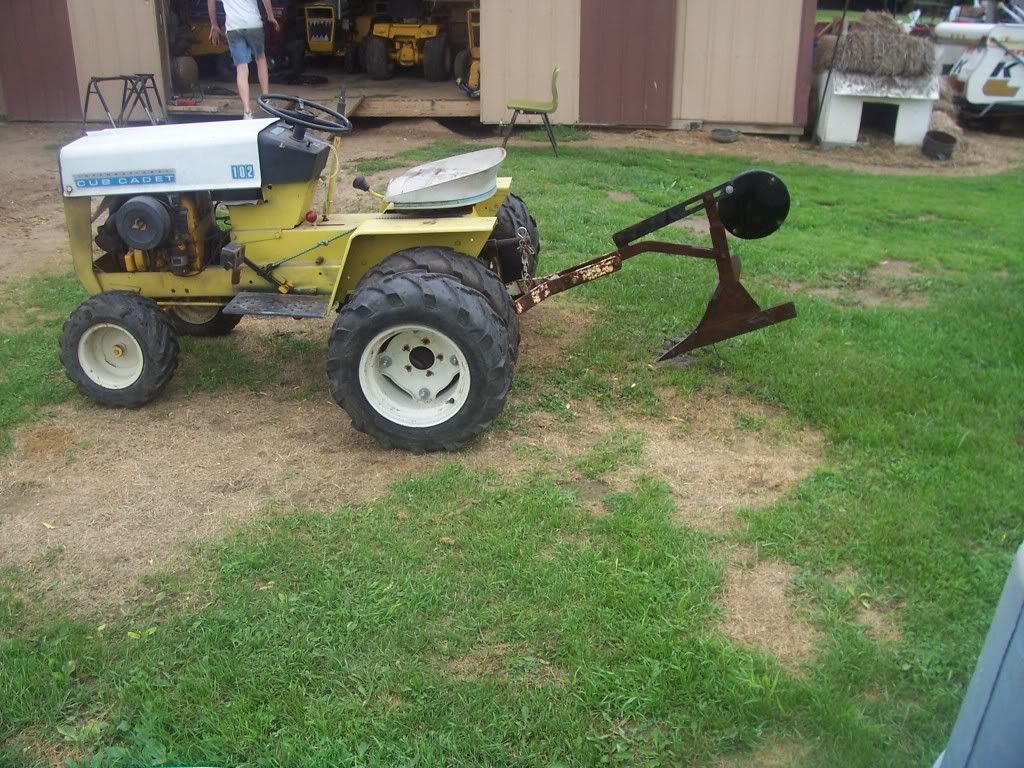

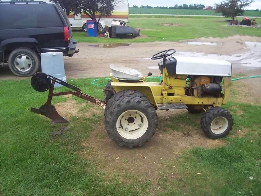

Well felt a lil better today so we put the plow i got last year on the 102 With duals just to see how it worked . problem i have is cant get it to go down in the dirt more than 3 to 4 inches , uness the kid stands on it .then it will go deeper

It looks like you have some very limited adjustments. I would try and fabricate a way of getting a turnbuckle like on a Brinly plow to adjust the angle of the plowshare. plus with no coulter, it prob won't cut in as well.

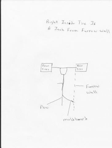

How wide is your plow?
This is the correct way to measure it:
The depth the plow goes is 1/2 the width of the moldboard.
8 inch wide plow is design to go 4-5 inches deep
10 inch wide plow is design to go 5-6 inches deep
12 inch wide plow is design to go 6-7 inches deep
You need to remove the right rear dual to get you tractor to plow right. It should look something like this one:
The outer cutting edge of the plow share should be even with furrow wall as shown in this drawing:
Not the best drawing.....

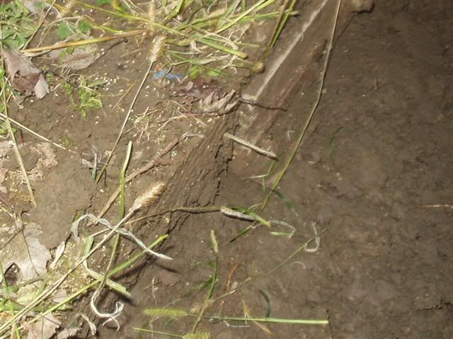

There is some ajustment for the point. When the point and the landslide should be against the furrow wall and and against the bottom of the furrow. Here is an example:
I would strongly suggest you invest in a coulter for your plow. It saves wear and tear on your moldboard and the plow will pull easier. I won't plow without a coulter.
The soil where I live gets dry and hard to plow this time of the year. That could be part of the problem. It looks like you use part tiller bracket to make you plow.

Another thing I see wrong with the plow is it is not set at the proper angle.
If you look at how a Brinly moldboard plow hooks to a sleeve hitch you will notice there is a built in angle to the plow beam.
This angle set the plow level to the ground when the right tractor wheel is in the furrow.
Without this angle I would find it hard to get the plow to work properly.

You probably just need to adjust the tip of the plow down. If you do it too much though, the plow willsink to China and bog down the tractor. I've seen info about it online.
