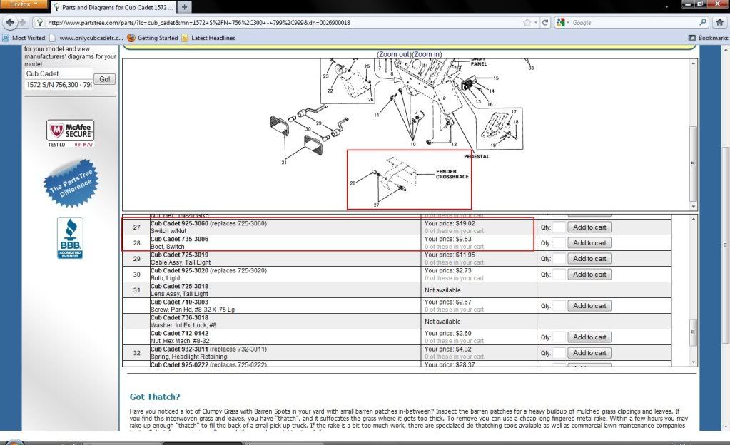

I found the two red wires that were supposed to be connected to the switch, they were cut and twisted together. No sign of a switch anywhere near the brake pedal assembly.
Would anyone have a picture of where the switch is attached?
Looking on the Messick site it appears to be located on this bracket.
Spring, Switch Operating
732-3039A
Old 05-09-2011, 08:32 AM
This was all I could find on Partstree.com

may want to check the cub cadet site under parts--enter 1572 model number
look under brakes--part 7 is the bracket that pushes in safety switch found under electrical--part 27 and 28.
I believe the original bracket that pushes in the switch has been updated to a better system. I have a 1772 and the bracket broke on mine which prevents the safety switch from being pushed in when parking brake is set.
sounds like someone wired around your switch.
