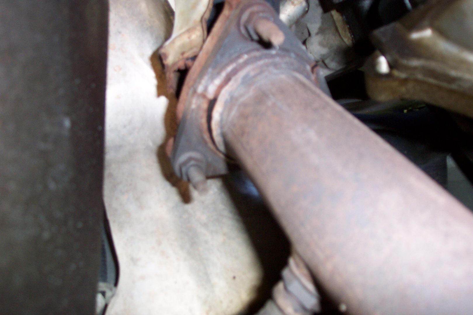

Last night on the way to store, I hit a small bump and the '01 Suburban instantly developed an exhaust leak. It was close to dark when we got home so I checked it out late this morning.
Turned out the exhaust flange on the passenger side exhaust pipe was in three pieces and the weld holding the flange to the exhaust manifold was broken.
click for bigger pic
I got the absolutely brilliant idea of removing the pipe so I could properly weld it back into place. After unbolting both ends, I came to the conclusion it's not coming out without using a saws all
I took the flange, wire wheeled it, ground a couple small chamfers on it and tack welded it back together. Put it back in place ( with the gasket ) and got the pipe back in position.
After removing the negative battery terminal, I did "one million tack welds" around the previous weld to secure it to the flange. Of course this was done laying on my back under the suburban while dropping hot spatter on myself. ( my full leather welding gear is at work 19 miles away )
It's done, it's quiet and even my wife agreed the welder is now completely paid in full
Only took 6 hours of fighting
