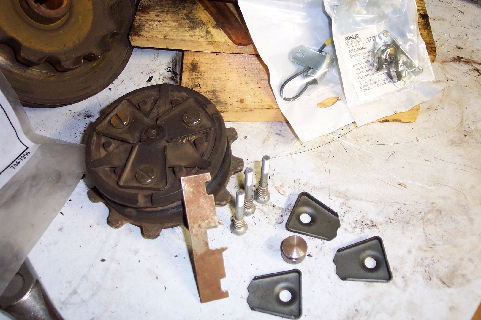

Which one is this and when you say spring does it look like a spring? I dont see anyspring on this one.

Yours like this one?
click for bigger pic
This is the one with the 6 pins/nubs. The other style is smooth

No. Mine does not have the nubs. So mine is single spriing then? When i order kit does everything come with it that I need? Thank you very much for the help.
It's always good to check out the sponsors at the top of the page for parts. I checked on the Cub Classics website and they have the kit on page 2
http://www.cubclassics.com/cubparts2.html
Just let them know which hub you have ( nub/pins or smooth ) and you'll get the correct kit
