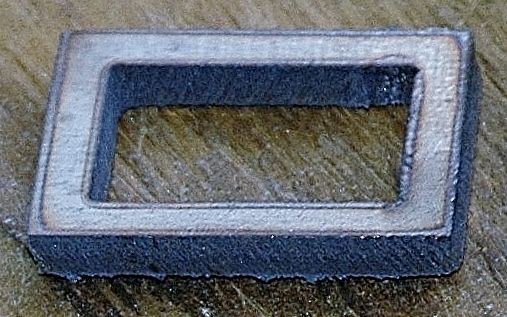

I happened to have the transaxle out when I welded mine in.
I made my own out of stainless steel.
I cut them with a plasma torch.
Just a little file work, a little angle grinder time and,,,,,,,,,,,,,,,

Mine was ready to fall off!! Out of square etc..........
Repair would have been far more work in my case.
Replacement was quick and easy, plus it is now stainless steel!!
It will never show any sign of wear again.

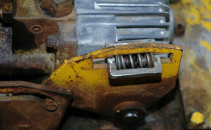

I used some old pieces of key stock on both sides and 45% silver solder. I just used a wet rag down near the seal and have had no problems.
Old 03-21-2013, 06:08 AM
Nice job Todd!
