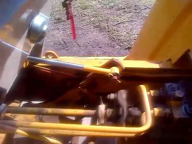

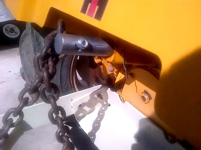

see vids.....if I adjust the chain, to keep it off the ground, it doesn't seem to go low enough to plow?......see both vids...(I know my fan is on the list)

I think you are missing a pin in your linkage. In the second vid you see the linkage pivot and it looks like there is a hole that should have a pin of some sort in it.

I put a socket extension I the open hole...didn't make a difference that I could tell.....

Do you have better pictures of the lower bracket that the plow is attached too?
It doesn't look like you have height adjustment holes in the one you have
The lift pin would go down much further with the lockout pin in, right now it looks like its set to float which stops it once the plow hits the ground

"The lift pin would go down much further with the lockout pin in, right now it looks like its set to float which stops it once the plow hits the ground"------huh...where is the pin supposed to be?
here is a lower bracket pic
pic I already had..if you need another, let me know

make sure your cam stop is adjusted properly.

First off, I didn't watch the vids because I have dial up...
A couple of things that I noticed from the pictures:
The chains that you have running to the rear-most part of your sleeve hitch adapter throws off the geometry of how the hitch is supposed to work. The way you have it hooked up, if the end of the 1" lift pin moves 4 inches then the back edge of the hitch adapter will move 4 inches... If the chains were attached closer to the pivot point of the hitch adapter and the 1" pin moves 4 inches then the rear-most part of the hitch adapter will move a lot more than 4 inches.
As far as the "float clevis" (the part that is attached directly to the moving end of the lift cylinder) goes, If you put the "float lock-out pin" in it, then you will need to set the "cam stop" so that it is at it's lowest possible position or remove it entirely, If you don't something WILL break. Since you are using chains then the float lock-out pin is of no use to you because there is no down pressure on the sleeve hitch adapter anyway.
Chances are; if you lower the lift all the way, then push down on the end of the 1 inch pin, it will go down further than it will under its own weight.
Since you are using chains and don't have any down pressure then it is up to your implement to pull itself into the ground. Depending on the angle of the implement where it meets the ground, it may pull itself into the ground, it may pull itself into the ground just a little, it may pull itself into the ground a whole lot or it may just skip across the top of the ground.
In any event, the first thing you need to do is move the chains closer to the "hinge point" of the hitch adapter. Then see what the implement does when used, then determine if you need down pressure or not.
