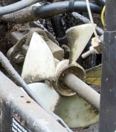

I'd like to see what they did for the drive shaft at the pump when you get a chance.
Old 05-03-2013, 09:46 PM
It is a very good coupling. This old machine runs VERY smooth.
It is two aluminum blocks with a metal flex plate, I think.
I didn't look too hard at it, Maybe I will have to clean it to get a better pic.
More pics later!!
I think the aluminum blocks are split on one side, and clamps with a bolt to each of the shafts.
