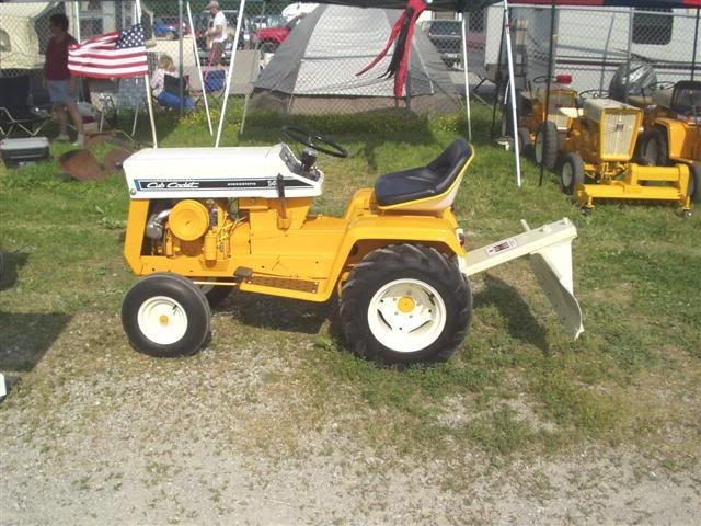

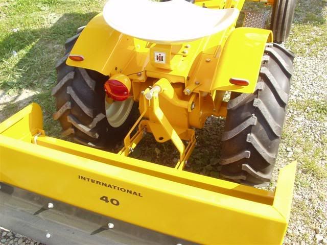

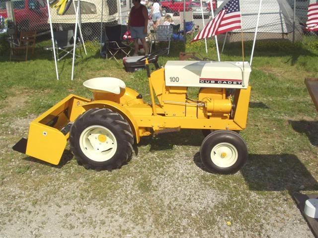

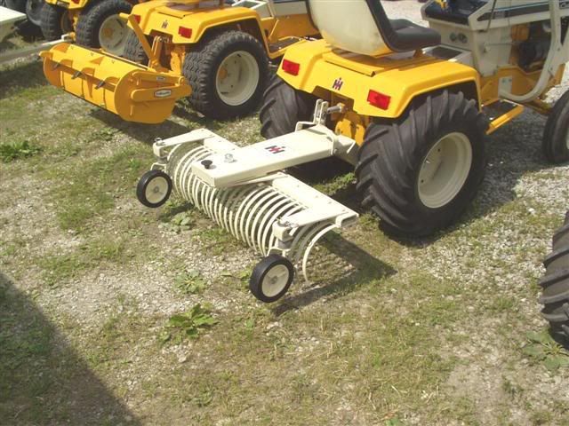

Few different views of a box blade and rear blade:

Does the rake/blade attach directly to the bracket rather than using the hitch adapter?

The IH blade/rake attaches directly to 3 point hitch. You do not need a hitch adapter.

The curve at the bottom just helps the blade load up better. It looks like the box blade with the round sides isn't well suited for pushing backwards. I'm speaking of the one (picture) with the landscape rake. The boxblade is in the background. I'd love to see it working but never have. The model 40 is simple and designed to push backwards as well as pull. I've never seen any rippers on one. If they were an option and someone knows I'd like to hear about it. I'd also like to hear if anyone has used a model 40. How are the traction issues when the box is loaded. I imagine it would require some weight (and having hydraulics is almost a must). I have a five foot boxblade I use with my Ford 4000 and when it gets loaded it have to feather the rear pto for traction at times and the rears are water filled.
Just my thoughts.....I too plan to build one similar to the model 40 but that will be some time yet. Too many cubs to fix first.

I was thinking of using a front mount plow and reversing it for the rear. I wasn't sure if a curved plow like that would be ideal for a box scraper. I could either make a piece to mount on the back to use it for pushing backwards (similar to that on the IH 40), or just build the mount to allow the blade to mount forward/backwards.

actually the box blade dont lift very hard. the first time i tried it out i had the manual lift on my 129 and no weights or ag tires and i didnt have any traction problems. i was only pulling sand though. if you were pulling more of a clay then ags and weight would make it alot easier.
