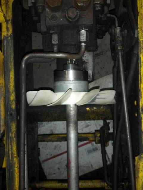

So first its the drive shaft... the grinding was a bad rag joint which took out a hydraulic line so out came the old clutch drive shaft and in went a 2000 series shaft with Sams couplers. Great work done my sam and the shaft is 100% once again. This issue fixed... done

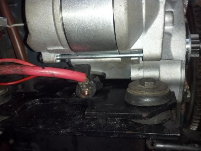

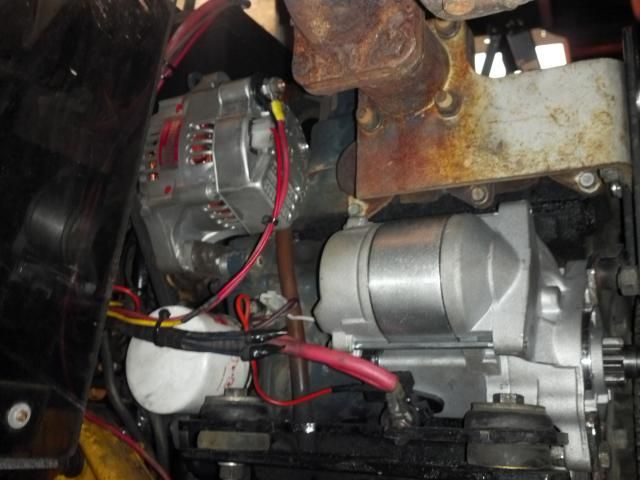

Next the charging issue, this one snow balled a bit but the fist time I hit the key it was the sound of success. I replaced the starter with a newer gear reduction one which is a dream in the cold with this diesel. This was a direct replacement with only having to do some clearancing on the motor mount below the starter. This thing cranks amazing now

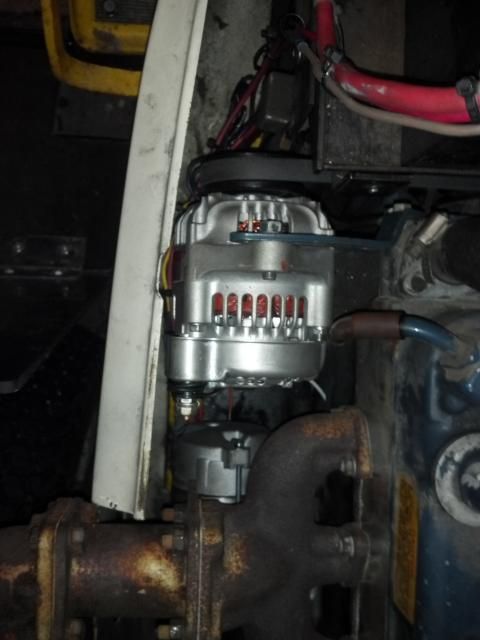

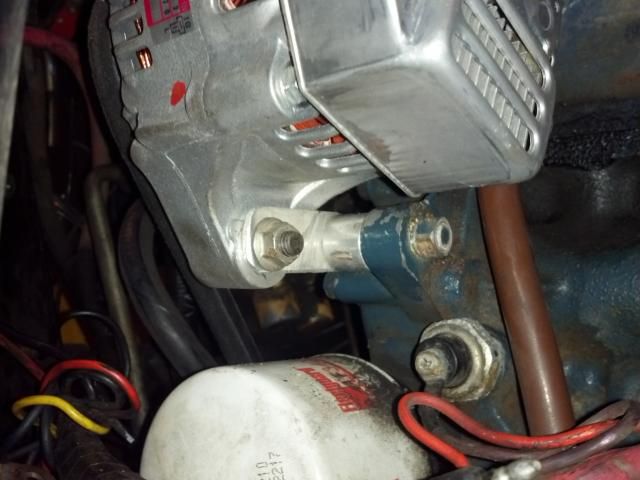

Next, I updated the alternator with a Kubota 40A one, this is the upgrade I was most excited about. it was easier than I thought it would be. I offset the lower mount about 1.125 and spaced it .75". I then elongated the top bracket hole then the alternator slid right in like it belonged there all along. As far as wiring it was simple, the main charge wire I ran to the battery with a fusible link inline, then the one wire off the plug I spliced into the yellow wire going into the factory voltage regulator (which I now eliminated due to the new alternator having it built in) I measured out a larger belt and whalla 14.2v charging at idle... a beautiful thing. U updated the key switch as well just to have a complete new system.
