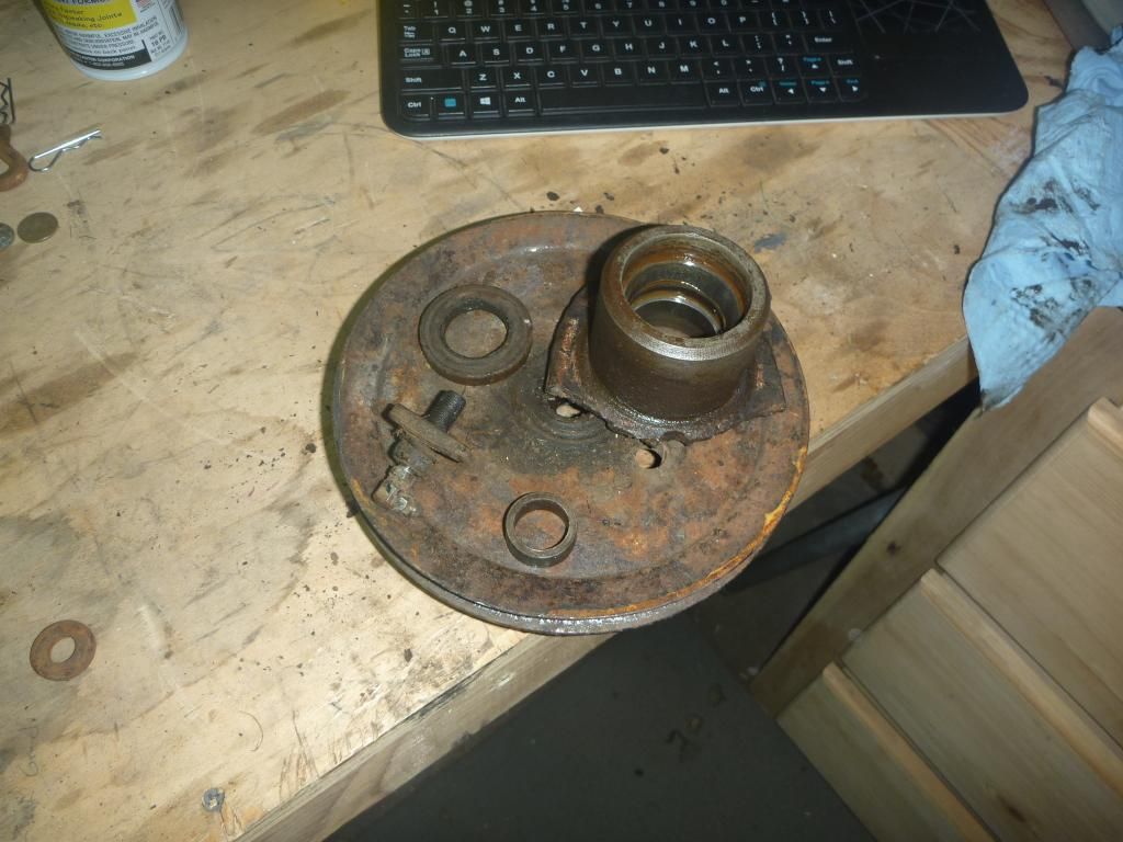

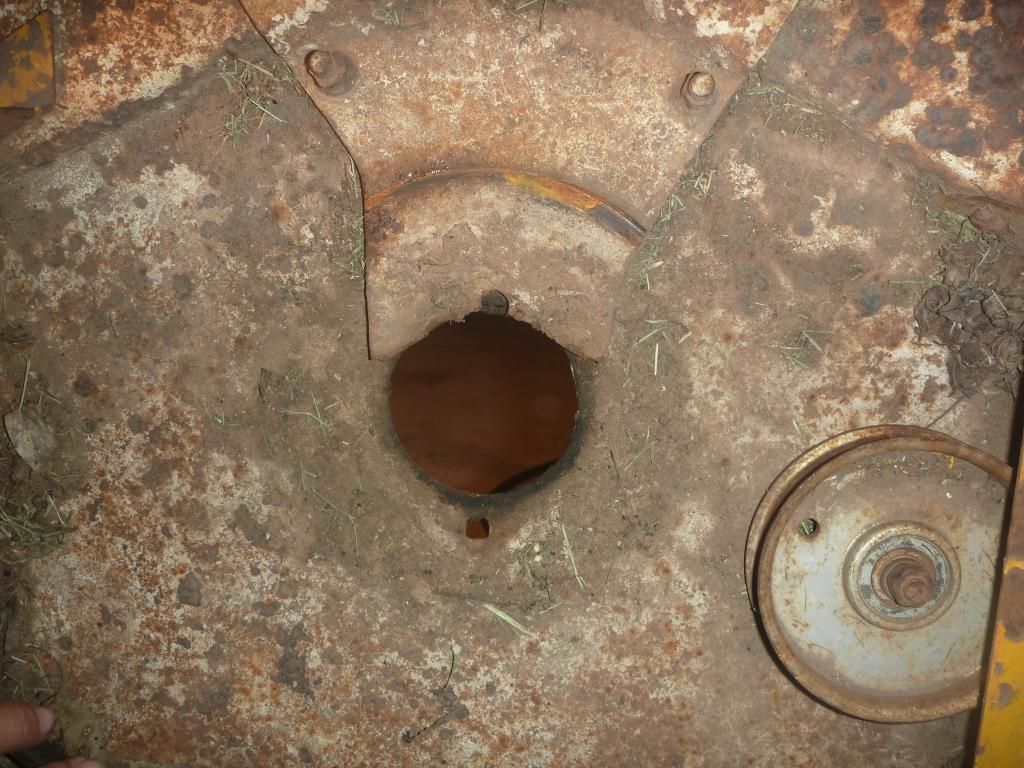

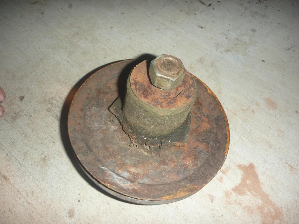

So, there I was all excited to switch out the subframe on my 100 so I could finally mow with it when I found it. Started to pull the belt off and the pulley wobbled badly. Uh oh.... I was just messing with it last weekend taking pics and everything and it was not broken. I remember turning all the blades by hand getting the pics. Anyway, it appears that there were two bolts missing on the back of the nose piece which led to the tension on the belt breaking the cast piece. Bummer. So it seems that I will need a new nose piece for this to get the deck going again, unless I'm missing something. Here area a few pics of what I'm working with.
Old 06-15-2014, 12:53 PM
I have a 42" deck that had that piece brazed back in place. It still works well.
