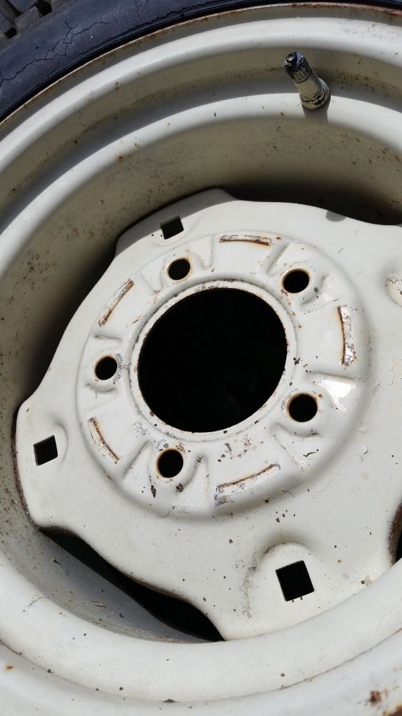

Also for some reason my narrow wheels have the valve stem on the inside and it rubs on the brakes, so I'd have to weld it closed and drill a new hole on the front side.
Someone put the tires on the rims backwards, I have a set that are the same way but not worth getting fixed. Have them re-mounted correct and you'll have your valve stems on the correct side
I'll get some pics of it but the valve stem hole is on the side of wheel that mounts to the hub flange. I'm not sure what these wheels are from, but they're not Cub.
I think I read somewhere that those are Wheel Horse wheels.
You are likely right, I google image searched them and they look the same. In the first pic you can see the stem and the area that mounts against the hub flange.
