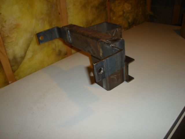

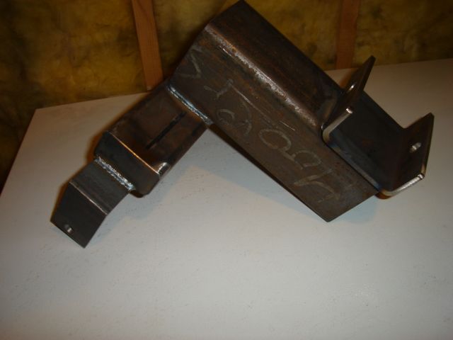

Or if you know a good fabricator , an adapter can be made to use it on a sleeve hitch adapter
Luckily we all know one.
