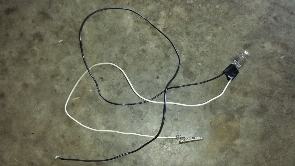

HEy Dave,
you want to identify when the points start to open.
If everything is hooked up I like the test light method because it's easy to see and you don't have to disconnect anything.
Made a test light very easily with an extra bulb from a 2 pack of taillights.
Did you use a meter or light?
- Tim

Hello Tim, I've got a decent Test light, Ice Pick Style- alligator clip.
