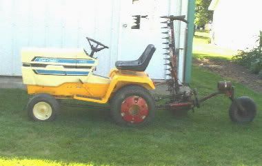

My Dad found a Haban that was missing some parts. He modified it to fit on the back of a IH Cub Cadet with a tiller attachment.
Dad removed the pulley and turned the tiller drive so it is facing towards the rear. The rear 3 point lift raises and lowers the cutter bar.
It only takes 2 pins, lift arm and PTO driveshaft to install or remove mower.

I have always thought Dale's Dad's setup was great. Seems practical to me. It doesn't require a dedicated tractor and relatively easy hook up.

I caught up with the owner of it today. After a little talk and showing some interest in his other stuff and tractors. I got it for $75, hoping to have time to pick it up after I go and get my new to me 108. I'm really interested in that rear setup, expecially since I'm setting up a 1250 that I just picked up a tiller for!
