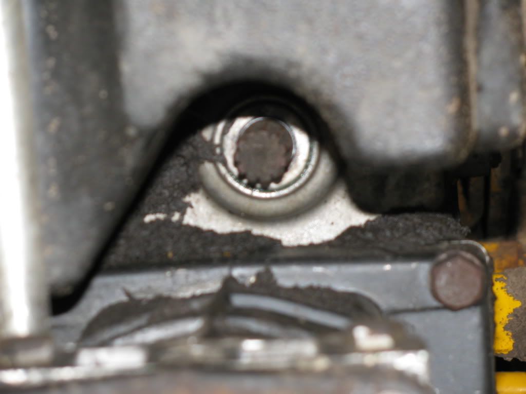

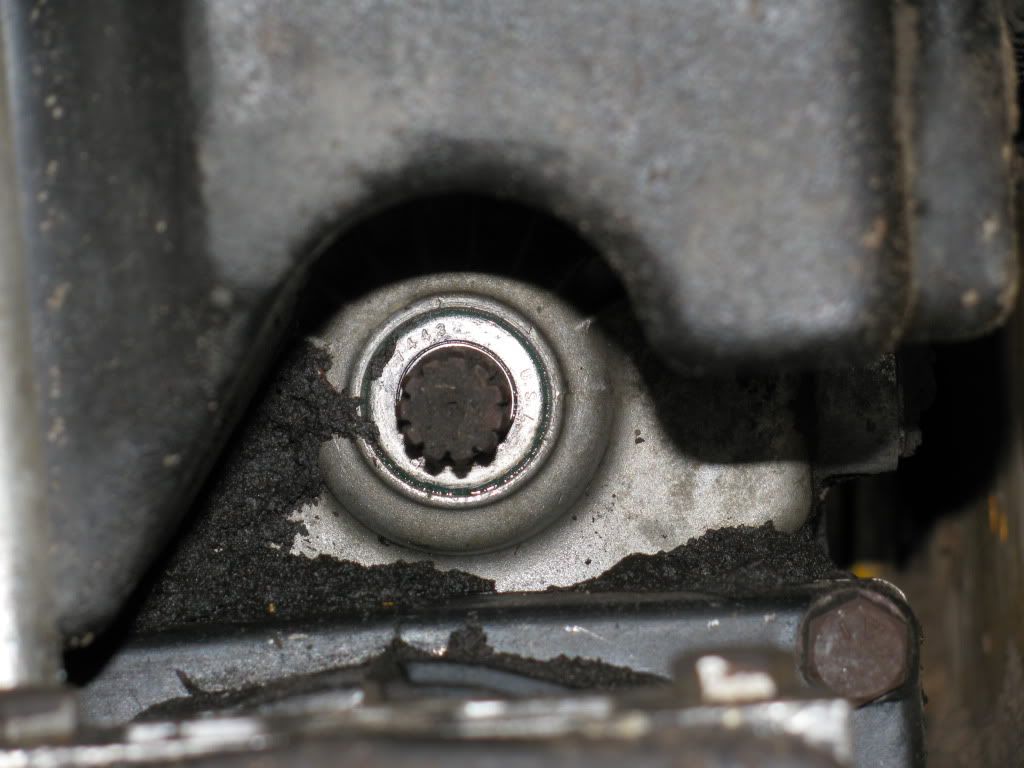

BEHIND the hydrostatic block, there is a PTO that is connected directly(??) to the driveshaft. The seal around it is leaking. Is it possible to change this seal without taking the rear end apart. I hope so.

At the front of the hydro on top those are the two release valves that are leaking out the weep holes. They need replaced, or you can try removing them and blowing them out with air to see if that fixes it. The rear seal can be changed without to much trouble. People have taken a couple screws and screwed them into the seal just enough to grab onto it and pull it out. You don't actually have a rear pto, it's just a splined shaft that's goes to the optional rear pto on a super. The new seal part number is 921-3032

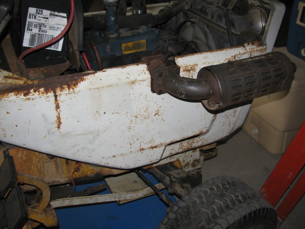

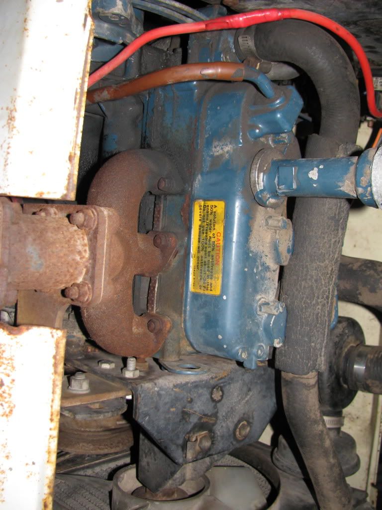

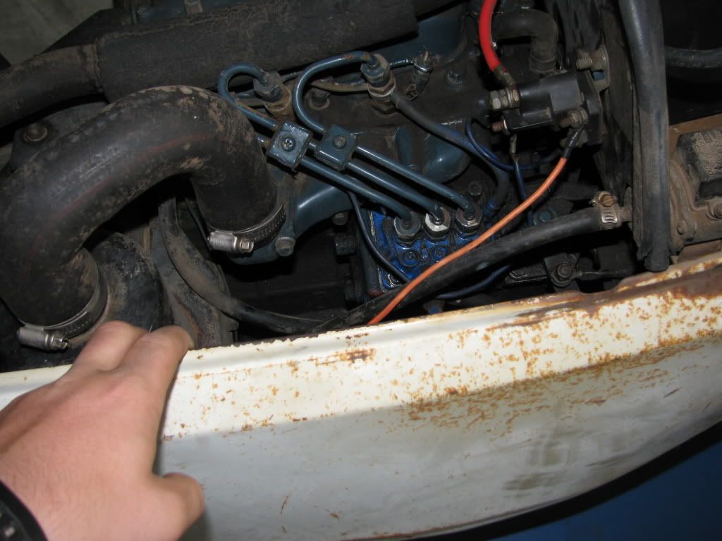

This may be a stupid question, but what engine exactly do I have. I know it's a diesel, but that's about it, I can't find any plates on it, but then, i'm not sure exactly where i'm suposed to be. I know where the one on the frame is, but engine, got me.
Is I have a Kohler, and if so, is it a series 1, or 2
Here are a few pics
Thanks
Cody

Cody: The engine in your CCC 882 is a 3 cyl Kubota D-600 Diesel engine. You need to go to www.binderbooks.com and order IH GSS-1509, The IH Service Manual for the Engine, Fuel & Electrical systems (Kubota Diesel). 782D's are RED! 882's are Yellow/White!, otherwise they are the exact same tractor.
The Kohler's both KT Series I & series II are twin cylinder GASOLINE engines.
Where are you in Louisiana?? I'm just over the line from Logansport, Louisiana in East Texas.

That's not an 882 either....I see an SGT front axle and brake pedals on the right, so that's a 1572.

Cody...Matt's got a good eye and I believe is correct about the Model. The engine is the same in the 882, 782D 1512 & 1572...
