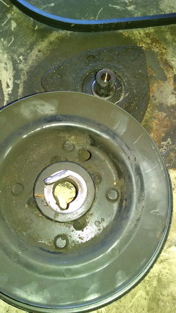

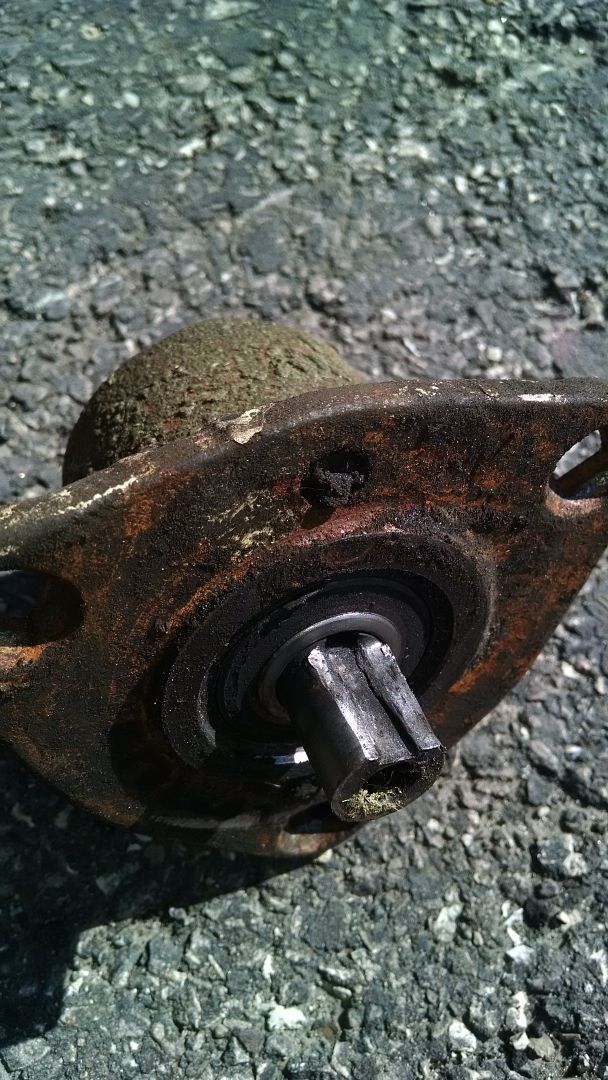

It looks like the pulley is all wallowed out, as well as the shaft. I took the spindle out. Do these look like the kind that come apart, or the one piece/non-rebuildable unit
