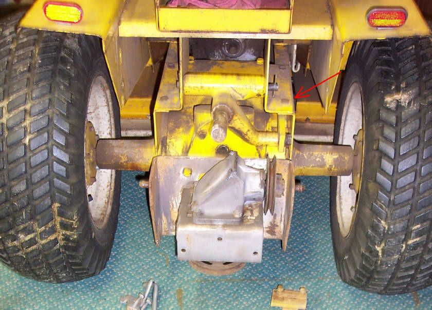

Here's my 1A tiller on my 125 ( it would be the same on your 1450 )

Not to detract from the OP, but what is used to mount the lower arms of the tiller to the gear box?
Old 07-27-2016, 10:09 PM
Hitch pins or clevis pins ( 1/2" diameter pins with cotter pin / hair pin holes drilled in them )
