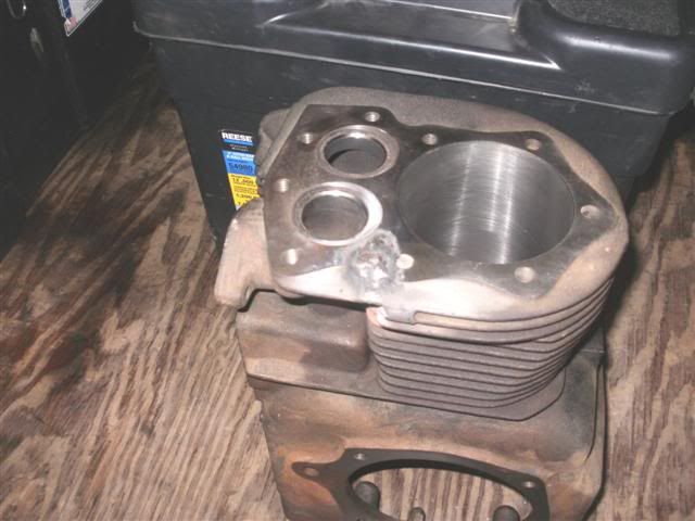

After buying it with a broken head bolt, having the screw extractor break off, then after getting that out have the tap snap off, I finally got the hole by the exhaust port cleared out. I know it looks a little rough around the hole but the threads from a 1/4 inch down are good. And I plan on putting head bolt sealant on when I reassemble it.
I started to clean all the grease and dirt off the block and noticed what looks to be an old crack on the fin. It barely goes into the block (see attached picture). Does this mean I need to scrap another block or it with still work to overhaul? Its a K241 that is .020 over and will only be used for mowing in a 100. Any insight is greatly appreciated.

You really need to clean it better so we can see, but it looks to me like it goes all the way to the valve seat. We're you going to overhaul it?? At .020" over already, it may or may not need more than another .010" to get a good bore. I'd say I'd junk it. That's really close to the valve.

It looks like the block has a crack (possibly 2?) . The crack looks to end close to the valve seat.
Can it be fix?????? It can be fix if you know someone who knows how to weld cast iron. To do it right you need to take a grinder and grind a groove in it. Them the block needs to be warmed to a certain temp before the block is welded. After the welding is done the block needs cool down to room temp the same way the block was heated.
I had a Kohler block that the machine shop was supposed to check for cracks before they do any machine work to it. Needless to say they forgot that operation. The was found when they shaved the block. My Son was working with a machine shop that had the capability to repair cast iron blocks for racing and pulling engines.
He said he would weld the block for $20. To me it was worth the gamble.

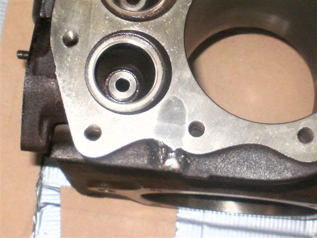

Here is picture after the block was welded:
After machine work was done to block:
The engine is in a puller that pulls in the stock class. It seems to run ok. It has 3-4 pulls on it and the tractor was park because remodeling a house is more important. This is my Son's puller.

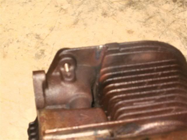

No it hasn't. Just found the crack today and don't want to spend more on it if its not worth it.
Took some emery cloth to it and got some more pictures.

What would scare me is what if you do nothing, put it together, and the crack continues to move--right toward the valve seat causing it to come loose. The right shop/welder can fix that crack and probably guarantee it. We had a 4 cylinder Massey Ferguson tractor block welded between the sleeves and re-machined for the sleeves--and the shop guaranteed the repair, cost wasn't that bad either. Trouble is finding a shop that will put their money where their mouth is. If it were me, I would see if I could find another block/engine since a replacement can probably be acquired for what a repair would cost
