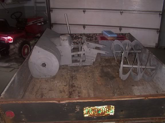

So basically, This is how they all hook up. Just replacing the blade with the blower/sweeper. leaving the sub frame & A behind. I know that each probably has the Sub & A of there own, but they are basically are the same on all 3??
Is this the same snow blower, that Is in the above pic, If so, All my questions ahve be answered, because i'm assuming that both sweeper & blower use the same set up.
And it only took me an 2 hours to find it. Whoo.
