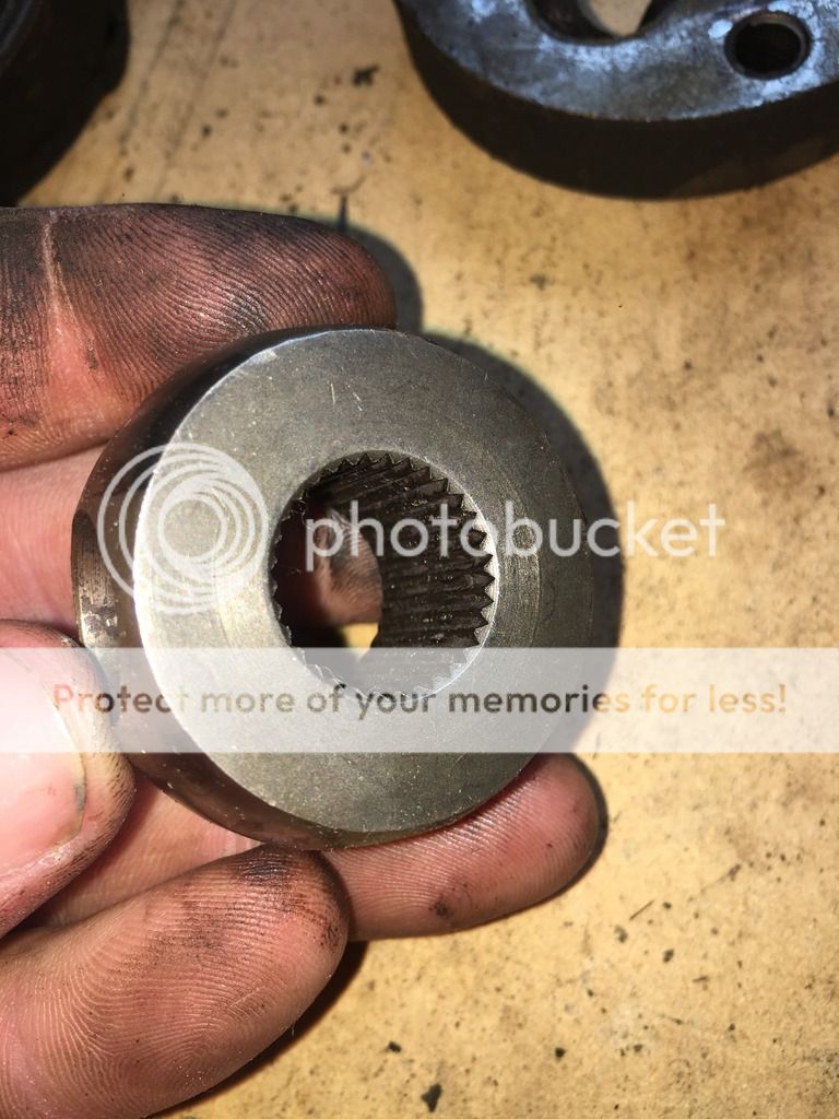

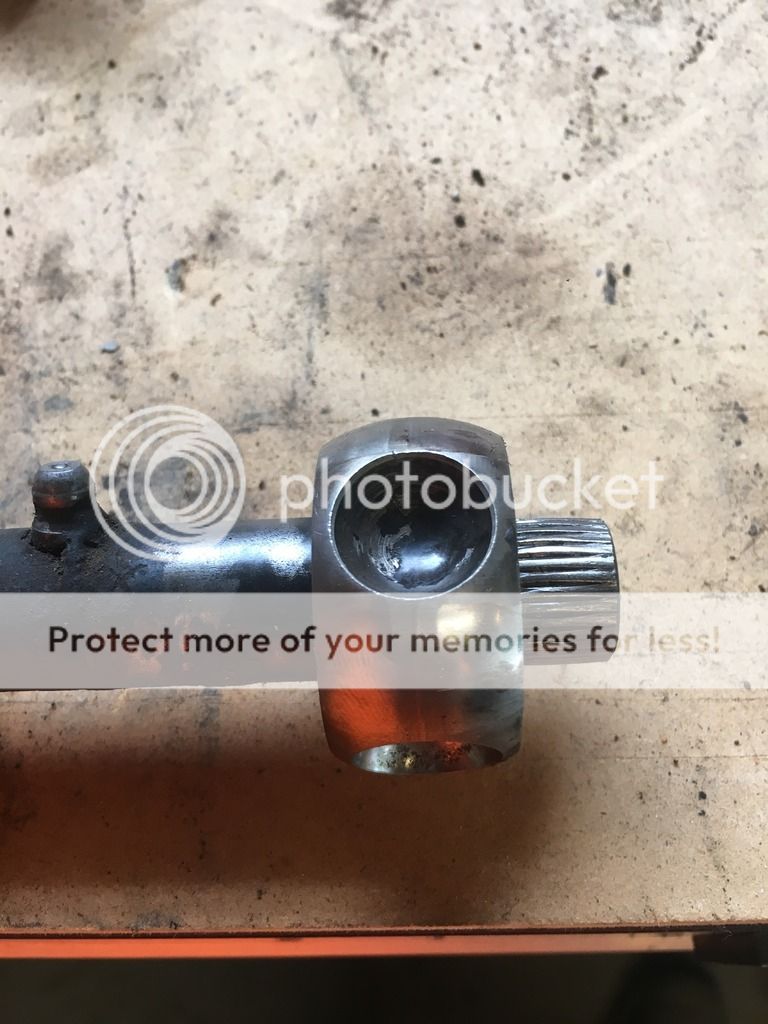

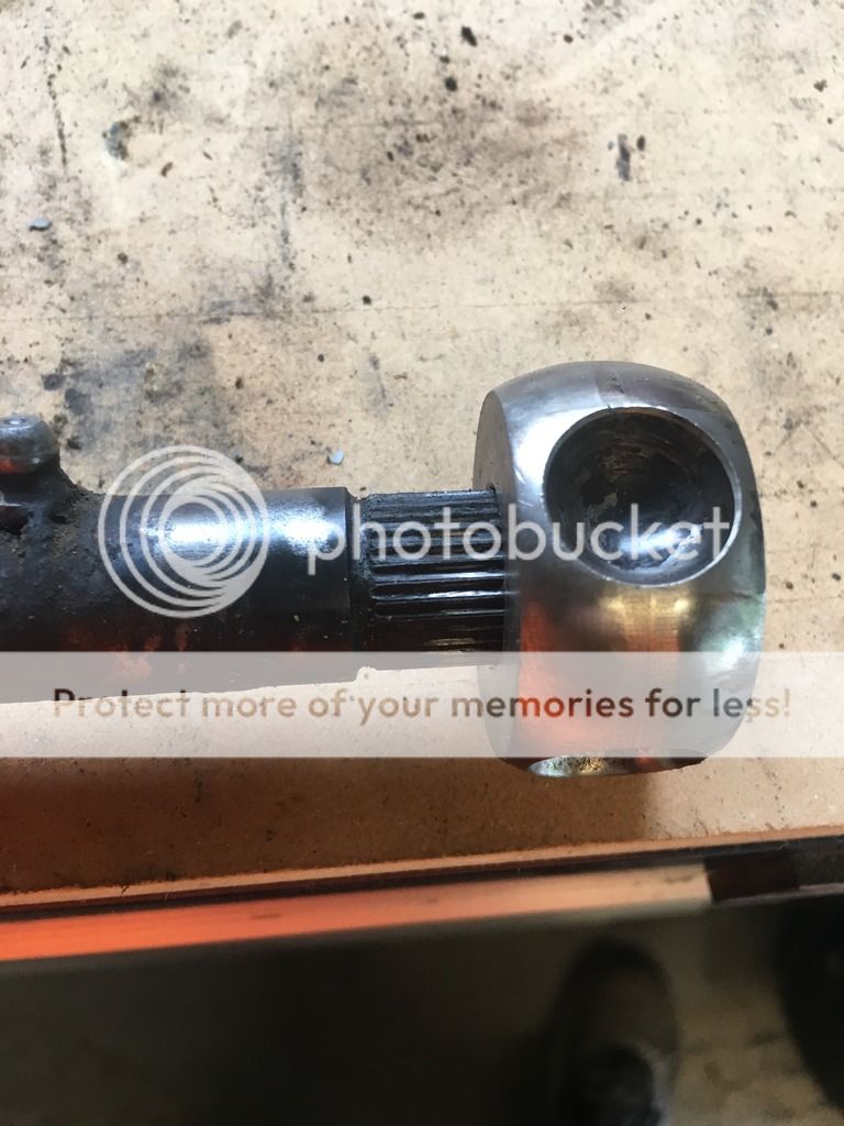

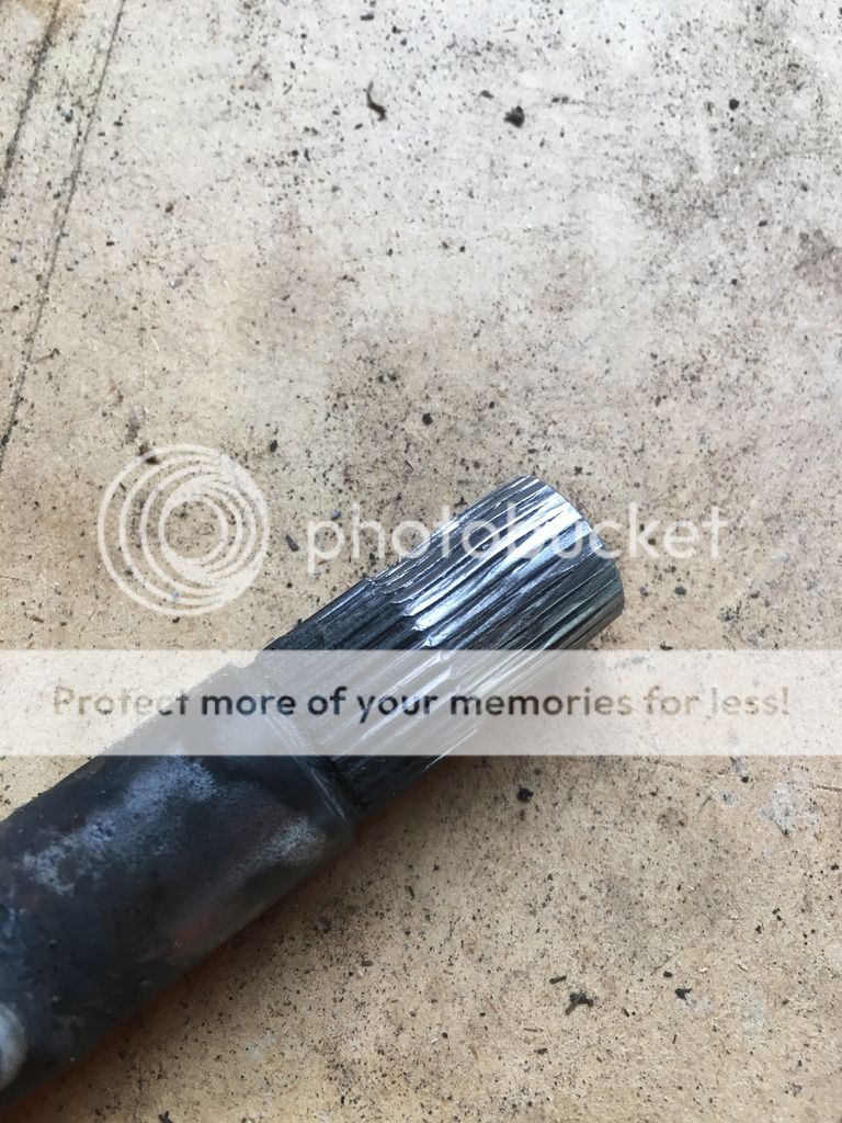

Ok here is the latest;
I got the driveshaft taken out this morning. I'll throw up some pictures and show you what I'm dealing with. It looks like the driveshaft splines are shot. They're twisted and worn down on what looks to be exactly half the length of the splines, where the forward CV joint meshes. Now, if the shaft were pushed in towards the motor further (only way I can think to do this is to move the entire rear end forward which seems impossible), the front CV joint would push further onto the splines and they mesh up perfectly, no slop or slippage. Where do I go from here? New driveshaft I'm assuming, with or without modification from Jeff in PA. I think I saw last night he machines new, longer, slip sections for the CV joints that allow the splines to mesh further - I'm assuming those would be in order also to prevent this from happening again.

That driveshaft is done. I would guess the other end may be OK for parts but the sliding spline end is trashed.
Looking on parts tree, you need a driveshaft 23.9 " long
https://www.partstree.com/parts/cub-...00/drive-line/
item 20
If you find another CV driveshaft, I can shorten or lengthen it to correct length. Can you measure yours to see if it's just over 23-7/8" long ?
In the PM, you asked about the splined couplers I make. That would be the one on the pump (rear ) that the driveshaft bolts to. I make that splined portion a little longer for more engagement.
Jeff
