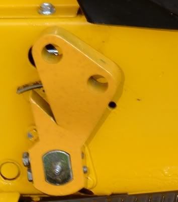

Old 07-06-2018, 09:21 AM
You need a special lever for the right side of the tractor to be able to lift the blade,,
This is a pic of my "DIY" lever that I made for my 1861,,,
I put two lift holes in it so that I could vary how much an attachment lifted,,
