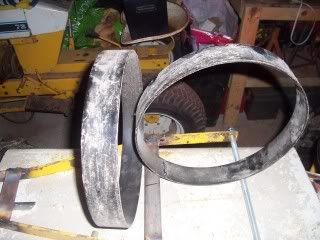

I got to my freinds fab shop and get a hunk flat steel 12 gage thick and sheer them at 40 inches long by 2 inch wide . ( some i have made 3 inches wide ) He has a roller to make it round . then a test fit , then they are weled on the inside of the ring , then i get some ready rod and cut 8 peices to size for bolts .This is what you get

i like (all) your thinking, i didn't know thats how they were done. on my economy powerking, the ones i made were like a spool, around a 6" diameter rings, 4 1/2" thick walled tubing. all welded together with bolt holes drilled at exactly the bolt hole circle on each ring. 6 holes on 60 degrees, 5 holes on 72 degrees and so forth. you can look at my picture album and look at my powerking with dual wheels. but working in a metal spinning shop (wenzel metal spinning, in scottsboro, alabama) i can most certainly accomplish that free and easy. thanks everyone!!!!
