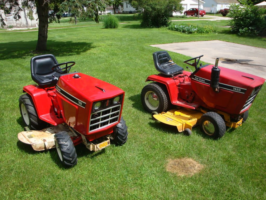

Old 07-11-2010, 09:23 PM
22Power 22Power is offline
Posts: 30
Old 07-11-2010, 09:25 PM
To me the spindle looks bent down.

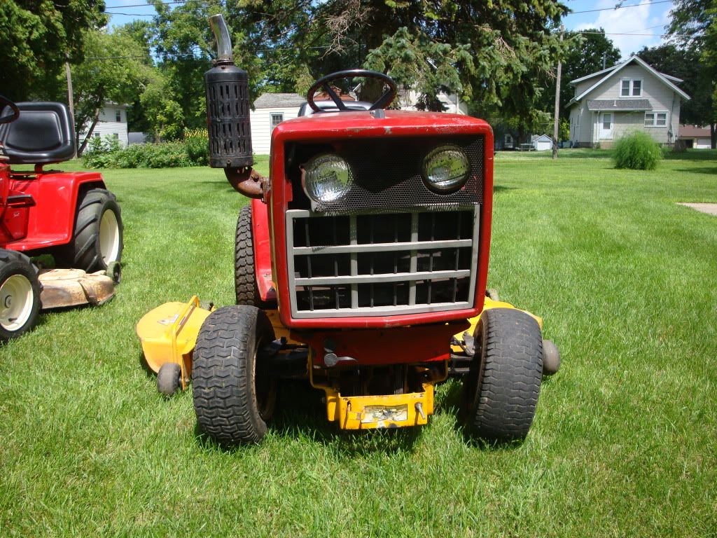

Old 07-11-2010, 09:28 PM
Posts: 30
Old 07-11-2010, 09:31 PM
Great looking cubs tho!
Old 07-11-2010, 10:01 PM
TEET's Avatar
TEET TEET is offline
Location: Macedon, NY
Posts: 868
Great looking cubs you have there 22power!...and I agree, looks like the spindle is bent down.
