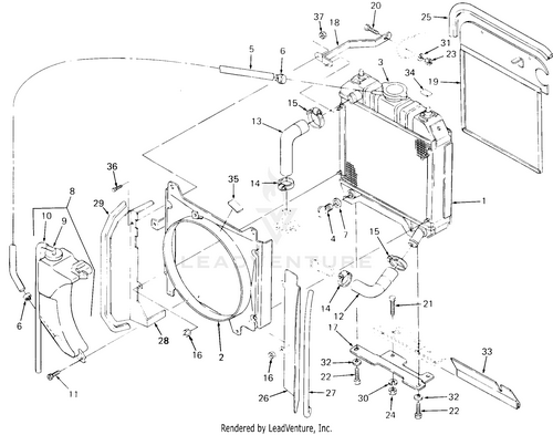

Once you get it off, Look for an octagon or round cap that fits... That may keep you from the extra work next time...

That is BULL SHIT. That "Tech" has no idea what he is talking about. Pull the screen that slips down between the radiator and the dash and you'll have plenty of room to remove the cap. I've owned two 2182's and a 1782 and they use the same cooling system.

I have the Cyclops Service manual in our files section. It covers everything about the 2182. Section 5-10 explains how to remove the screen.
