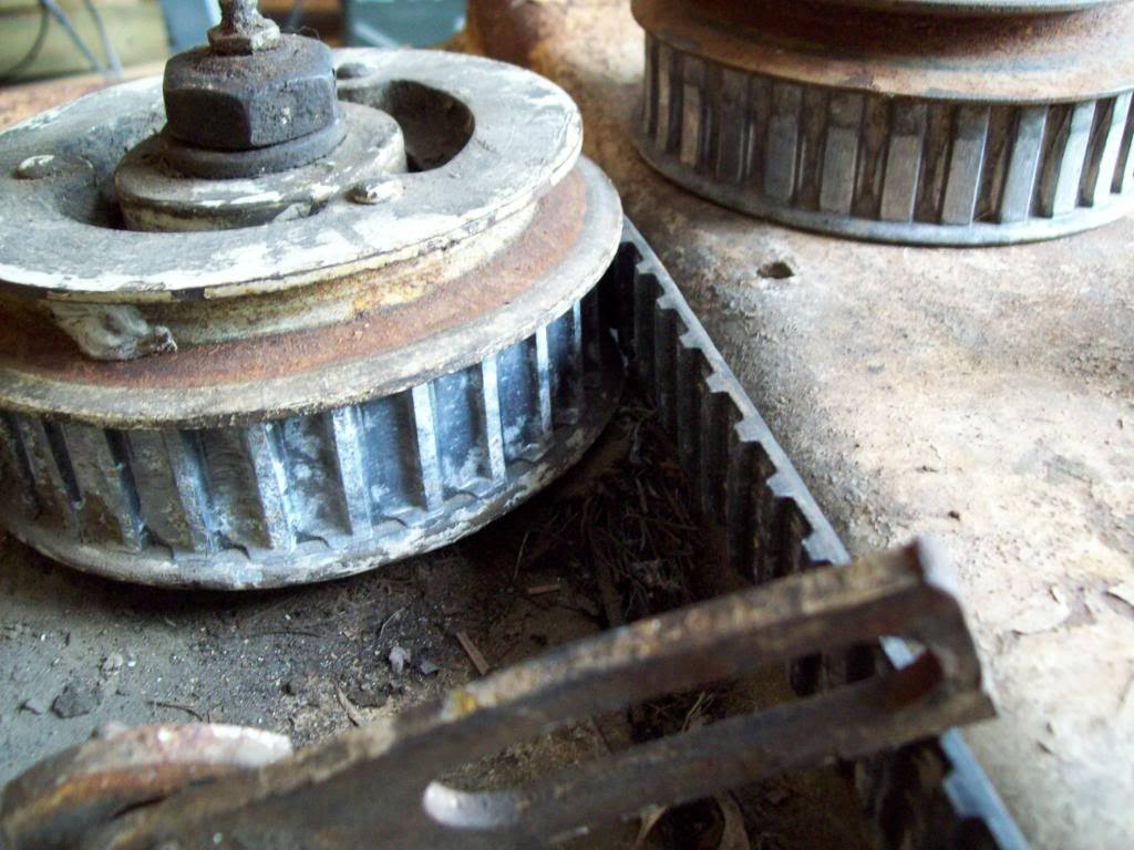

Hello OCC,
How bad can the geared pullys be worn before it has an adverse affect on the timmed belt?
My driven gear is worn badly, and I want to purchase a NEW timmed belt.
BUT I do not want to ruin the belt.
The driving gear looks awsome. Only the R.H. gear is worn????

I would not go too much more worn than this one..
I messed with it a bit before I took the deck apart, and it kept OK timing. I would be very carefull on hitting stuff in your lawn with it though it will jump a lot easier. The bad thing is I have seen good ones and NOS ones go for $80 plus for one. Is that price worth it? guess if you want a good solid deck that bad.

Thanks Jaybrd,
Yes my driven pully is at least as bad as the one in your photo.
Looks like you have a replacement ready to go on?
Yes that is what I'm afraid of $80 puckers the backside pretty good.
What even more scary is I'll find a good one after, for cheep.
Most ebay auction photos are so far away I can not see the teeth so I wont bid.
I bought a complete deck and the gears are margin-ally better than yours.
