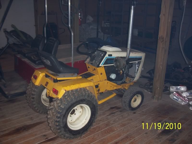

been doing alot of reading on here for my latest project and got some ideas and hints from this site, figured i would finally join and show off my creation......
name is corey and i am from SEPA, diesel mechanic by trade. i have a 680 hydro that we bought for 200 bucks and ran ok. well after a while the kohler was using about 1 qt an hr, so i tore it down. piston was already oversized to 30 over, and after thinking about it, i didnt want the kohler anymore. so the search started. took about a year to find a motor and all the parts to frankenstein the tractor together, but now that it runs and drives i love it. stll need to finish up a few small things and then then do the body work on it, but it is alive now....
680 hydro, d950 kubota engine, honda civic radiator, ford one wire alternator, 2 gallon moon tank, and lots of time and thinking.
next time i have it outa the shop i will try and get better pics.

Great pics! That loks pretty cool! Got any pics of the in progress stage of the build? More details on your build would be cool too. Lots from PA here.

no progress pics, didnt have a cam then. when i tear it down to paint it i will take some pics on the mods i had to do to get the motor in there. but i am still using the stock engine plate still rubber mounted, stock "rag joint" on the driveshaft but only at the rear, in the one pic u can see the ujoint up at the motor. i want to clean up the motor mounts a little and make a nicer exhaust. still need to figure out the grill and headlights. dont wana put the factory peice back in for the headlights. was thinking of making a custom grill and mounting some old teardrop style lights on the outside of the grill surround. also wana make some braces for the grill surround since the radiator is mounted to it.
and just incase some of u was wundering about the hood scoop, i needed it to clear the upper rad hose. it is off a "cough" bowlens "cough" and worked great.

Welcome to the club!! Nice work you've done there, would like to hear that run

like i said, next time i get it outa my shop i will take better pics and maybe a video....
