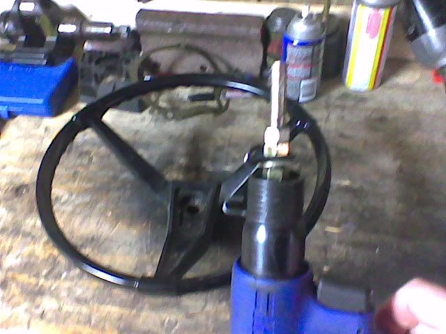

Only use that if you want to replace the bearings in the column. Here's what I use:
Attachment 9505
Do you use this same puller on 104 thru 147 ? If so how do you protect the plastic hub from damage using that type of puller set up. Also could get ugly using one for a Original due to a hollow steering shaft that will flare out at the threaded area. I have been using the PB and "tap & go" method for years but I also have a bearing separator/puller combo like your set up...great for low profile wheels that is close to the dash.
Fool me once shame on you,fool me twice...shame on me!
Old 03-27-2011, 08:15 AM
I only have 82 series tractors and an O...haven't touched the O yet. All of the steering shafts are hollow. What you can't see in the picture is that I'm using an additional round piece between the steering shaft and puller to prevent mushrooming the shaft.
