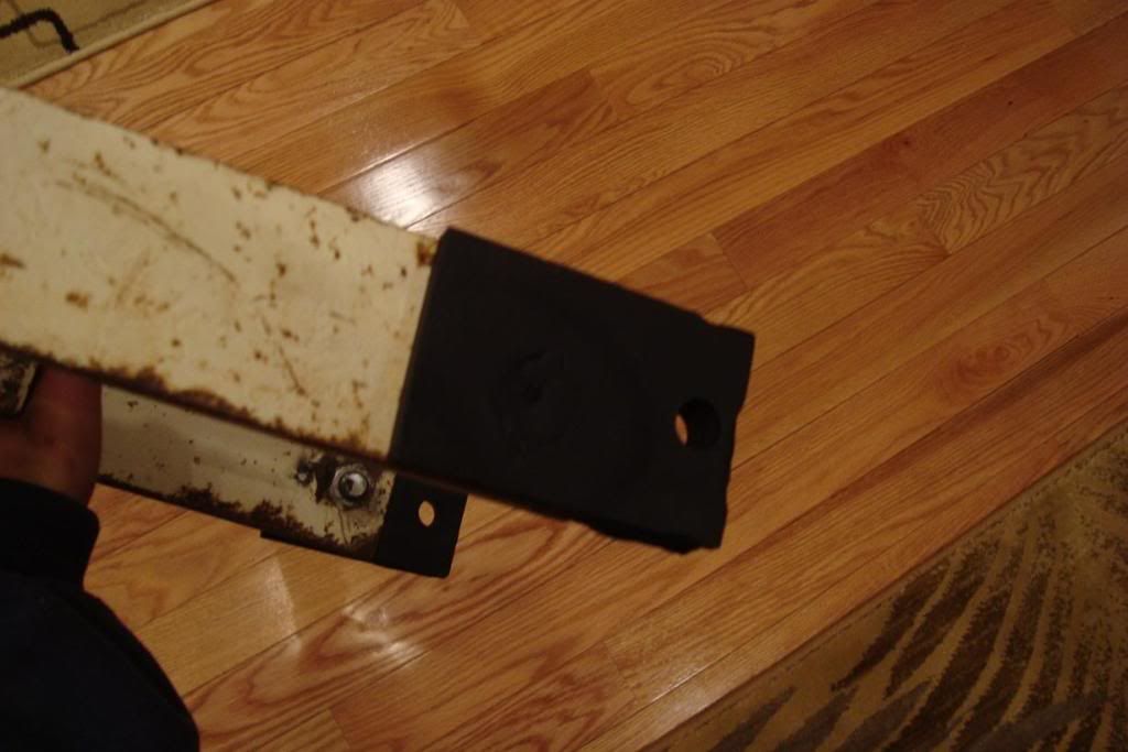

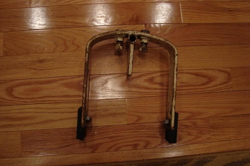

Some pics of what mine looks like.

Heres what i did...i also made a round lift rod that is longer...
