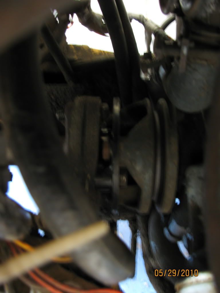

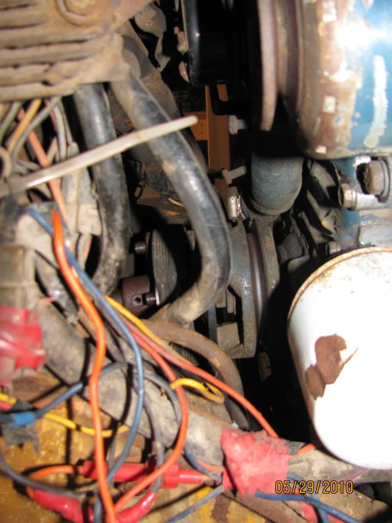

We noticed that the rear engine belt was very loose, and the altenator was all the way taunght. Well we thought that the front part of the driveshaft would come off, by taking those bolts off, well it didn't. We pulled all the one, which is blocked by the roll-pin. If we remove the roll pin, will that allow the driveshaft to get out of the way, or will it do nothing.
We then tryed removing the rear rubber thing, they have one at the front & rear of driveshaft. The stuff that reduces the vibrations. That didn't work either. Will removing that roll pin allow the driveshaft to get out of the way.
Any help would be appreciated.
How would yall do it.
What is the easiest way to remove the rear belt. that goes on the driveshaft pully, the waterpump, and the altenator.
Am I approciing it from the right angles, or going at it all wrong.

Take out the battery box to give yourself some room. Knock out the spirol pin that connects the front rag joint coupler to the driveshaft and slide it backwards on the shaft. Unbolt the flex discs, slide them back. Remove the 3 bolts that hold the driveshaft coupler/pilot bushing onto the crankshaft pulley. They are metric and you'll probably have to hit the wrench with a hammer to loosen them and retighten them when you're done. You can now move that to one side or another or wherever you can get it to clear, and then you'll have room to sneak the belt off and a new one on. Reassembly is the reverse of disassembly.
I'm not going to lie: this is a major PITA...I've had two diesels, and I hate changing alternator belts. Thankfully, I won't need to for awhile now.

Elephants: Matt G told it correctly. When the bearings in the Alternator on my 782D froze and ate the Alternator belt, I had to do the exact same procedure to reinstall the a new belt after the Alternator was repaired. Aaaargh!!

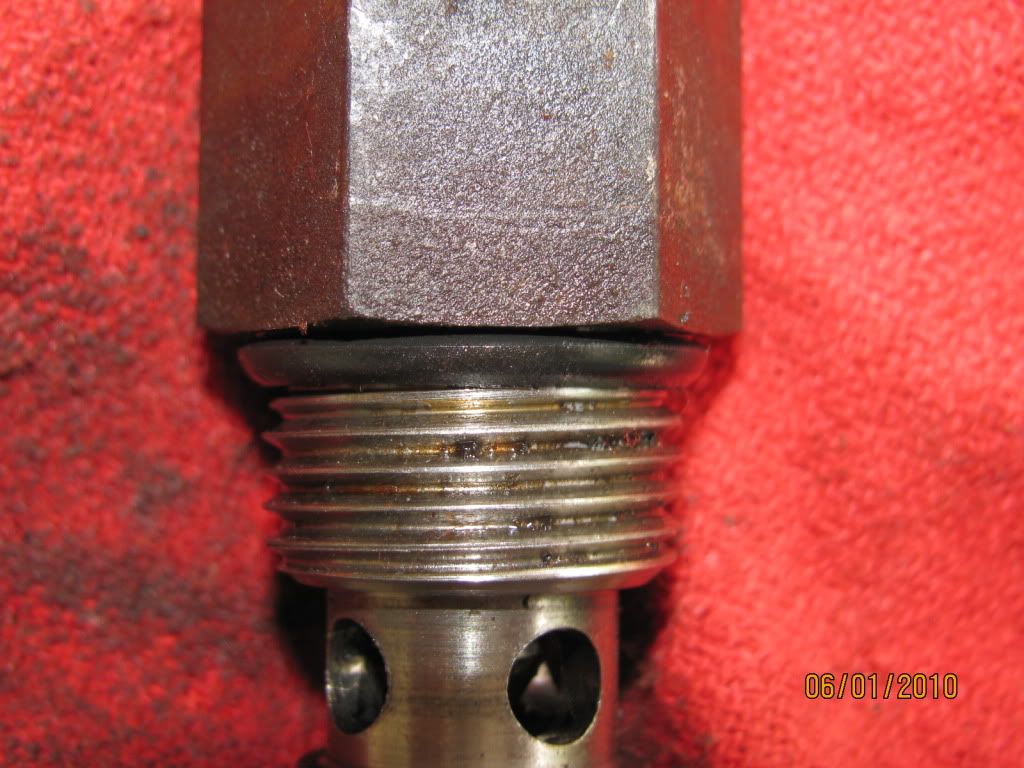

The pressure relef valve, Should the O ring on it, be conical, or cylindrical.
I knoticed that after I rode around for about 10 minutes, I went into the house to get a water, and saw that there was a puddle on the concrete.
Is it suposed to be conical. Because I'm thinking that that's the reason she's leaking. It's not comming out the top, but out from the bottom, around the seal.
I'm hoping that this is the issue, because that would mean, after this, she's LEAK FREEEEEEEE.

The alternator comes apart and you don't have to worry about anything flying out of it. When you have it apart you may want to check the condition of the bearings in it. I had to take mine apart because the bearings went bad. Mine was also very dirty inside and after cleaning it up and putting the new bearings in it charged better. If you need to get a new one, do some good searching the cheapest new one I could find was about 120.00. I've reused those orings and haven't had a leak but it wouldn't hurt to replace it and see what happens. Eventually if you need to replace the valve, do a search on here for a great price direct from the manufacturer.
