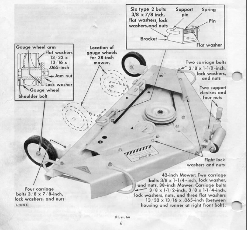

You have the wheels on the wrong side of the bracket and the bracket reversed. Here is a picture of how you can mount the wheels and brackets on your deck. This is found in our Implement Technical Library.

Man, you guys are as bad as my wife, always right. Course, that's why I keep coming back! Sorry Matt. Thought maybe once I could geta leg up on ya! Maybe my clearance problen is due to my skid bars being more flat than round?
Thanks for the pic. I was concerned with the brackets going above the deck. I see that is correct.
